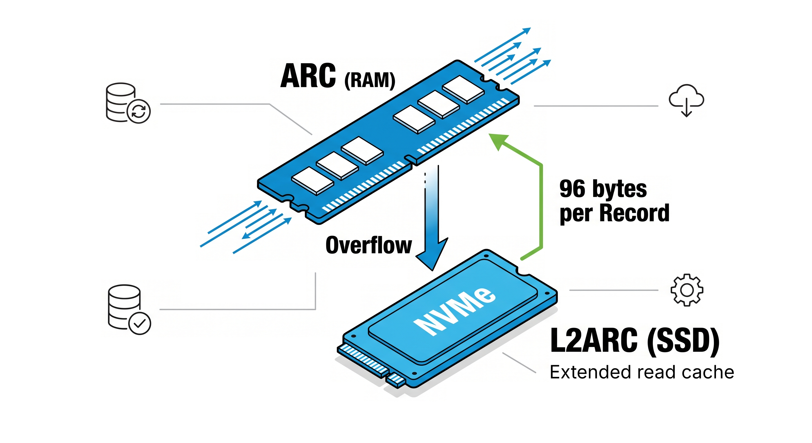

L2ARC – the Level 2 Adaptive Replacement Cache – extends ARC onto dedicated cache SSDs that give the read cache a second, larger tier to work with. A few things about it matter more than the rest:
It’s read-only. L2ARC accelerates reads, but does nothing for writes – that’s SLOG’s job, protecting synchronous writes on the way in, not reads on the way out. Good L2ARC devices are able to deliver rapid random reads – so while NVMe SSDs are the natural pairing here, anything faster than your pool can help. Community Edition users short on PCIe lanes or M.2 slots will often attach a SAS or SATA SSD to act as the overflow.
It’s non-critical. If your cache device dies, you lose nothing but the speed boost; TrueNAS falls back to reading from the pool like the L2ARC was never there. L2ARC is a simpler process as well; it doesn’t carry ARC’s adaptive intelligence. It’s closer to a sequentially-written overflow shelf that catches data on its way out of RAM, rather than a second brain making its own decisions.
Think of ARC as the librarian making judgment calls, and L2ARC as “more shelf space.” The shelf doesn’t decide what’s worth keeping – ARC already made that call in RAM – it just gives ZFS somewhere fast to put more of it.
OpenZFS feeds L2ARC deliberately: a background process scans data near eviction and writes it to the SSD in controlled, sequential bursts, which keeps the write pattern SSD-friendly and avoids burning endurance on data nobody will re-read. And in TrueNAS, L2ARC is persistent across reboots, so a maintenance window doesn’t force the cache to start cold.
L2ARC Costs RAM Too
This is where “just add a big NVMe cache” plans go sideways. Every block L2ARC stores needs a small header in ARC so OpenZFS can find it – 96 bytes per block. That sounds trivial until you do the math against your recordsize and L2ARC size.
With large records common for media or backup files (say, 1M), you get relatively few blocks and the overhead barely registers. But with small records – 16K for virtualization, or even smaller in some cases – you get far more blocks for the same cache capacity, and that per-block overhead starts eating into the RAM you were trying to relieve in the first place. TrueNAS does cap how much ARC can be consumed by L2ARC metadata in order to prevent an overly optimistic administrator from accidentally scoring an own-goal, but the principle holds regardless: an L2ARC sized without regard for recordsize can quietly work against you instead of for you, or end up as wasted space that won’t be used efficiently.
The rough formula is capacity in KB divided by recordsize in KB, times 96 bytes – and it’s worth running before you buy the SSD, not after.
