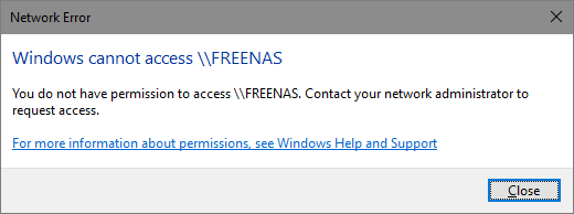

I ran into one of these trying to follow Festers guide for sharing;
Specifically while mapping a network drive and browsing to the target.
I have login credentials, but it wont give me the option to enter them.
Not sure what I should do about this.
joeschmuck
Old Man
May 28, 2011
10,996
I have login credentials, but it won't give me the option to enter them.
Set up the permissions on your shared drive will fix this problem. I typically just share with everyone on my local network but if you are trying to share only one account, then you need to have it all setup properly.
