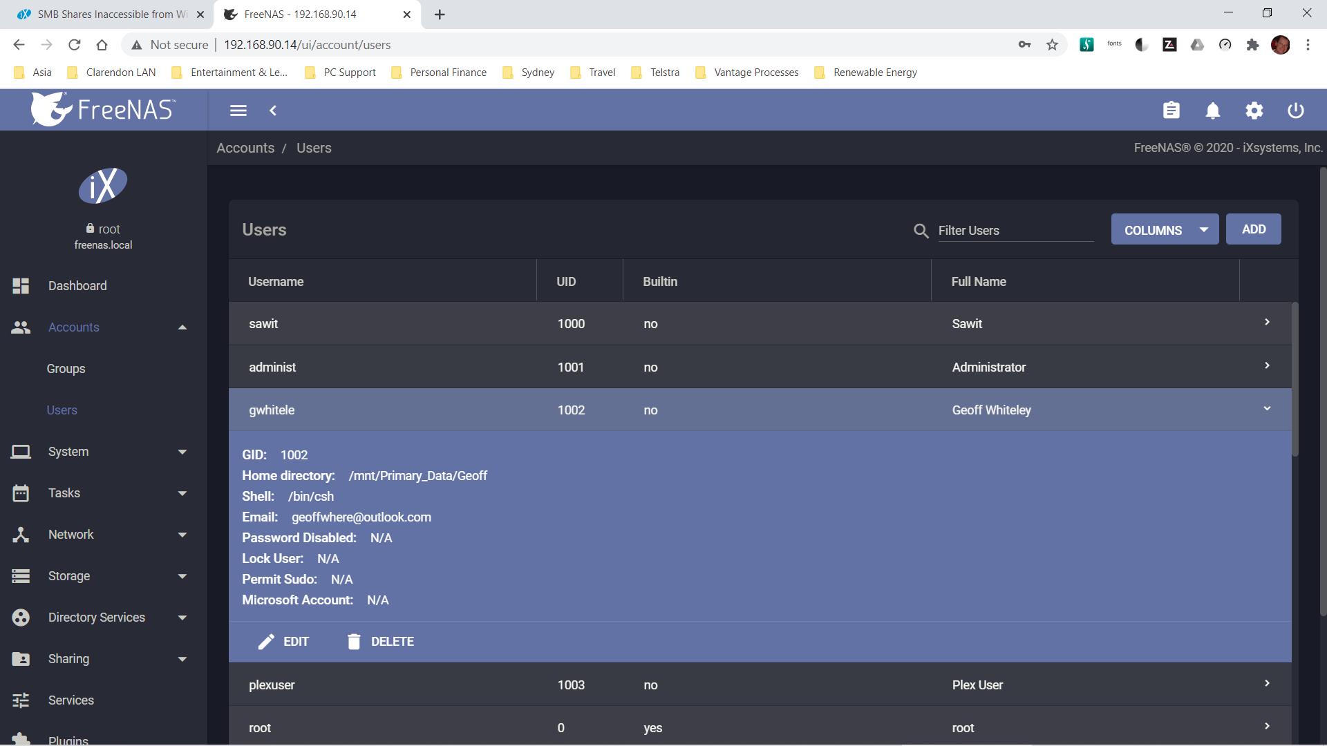

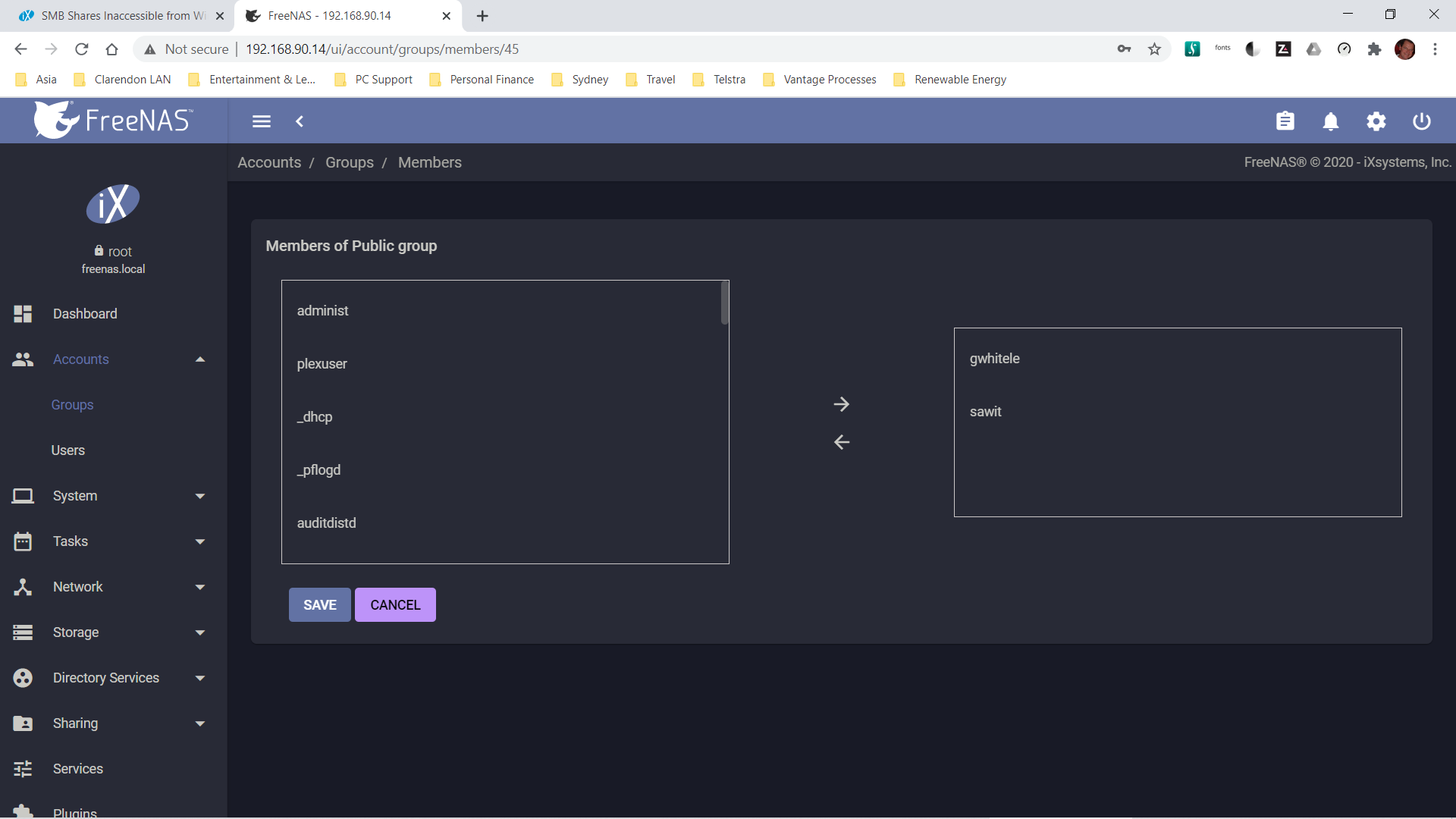

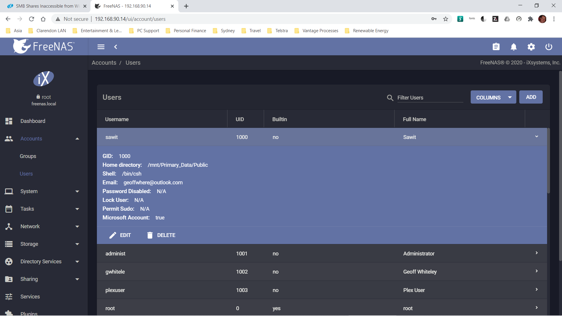

The only change here from the original setup was to add User 'gwhitele' as a Member of sawit group, but I still get the error "The specified network password is not correct".
Baffled. And thanks again for your response and ongoing detective work.

What user account are you using to access these shares? According to the ls -ld output, the Geoff share is restricted to the gwhitele user or the Geoff_private group. The Public share is restricted to the sawit user or the Public group. Is your account a member of both groups?
Hi Samuel, Further to my earlier reply about your above struck out question on my FreeNAS account members and groups, the mystery has deepened.
My desktop PC involuntarily updated to W10 Build 2004, and that introduced further quirks around network drive mapping. In the process, I discovered accidentally that my Firewall (ZoneAlarm) had blocked the mapping to the other (standalone - non FreeNAS) devices, but I was able to fix that within the firewall settings. On investigating whether that might also have been the problem with both FreeNAS and Plex IP addresses, that drew blanks as no firewall settings seem to be preventing access.
Strangely, W10 has been intermittently disconnecting from those non-FreeNAS drives and I'm having to remap to them every few restarts of the W10 PC. That's no big deal as, despite the annoyance, it's easy enough to reinstate their mapped status.
Even more strange, the Plex virtual server running on the FreeNAS box now won't allow download of image files, even though the Plex interface dashboard displays all the folders (which are actually on the FreeNAS Share) and related image thumbnails. Before the W10 b.2004 update Plex was fully accessible from the Windows Browser dashboard, even though my FreeNAS Shares (on the same server but with a different IP address) have not been. Now, both IP addresses reject mapped access requests from Windows. (I understand that the Plex access is granted by login at the FreeNAS point, so refusal is most likely to be from the inability to connect to FreeNAS.)
As you can probably imagine, I'm going out of my head, and over it, trying to break down all the various potential points of failure, but obviously still without any success.
While I greatly appreciate your help and guidance thus far, I feel I may be wearing out my welcome and might need to look for a different solution. But the thought of salvaging the important files and deconstructing the FreeNAS and Plex server might be a bit too much to take on right now.
So I'm holding out in the hope that the information I've provided can lead to an 'Aha' moment and we can all walk away with huge smiles.
Regards,
Geoff Whiteley
