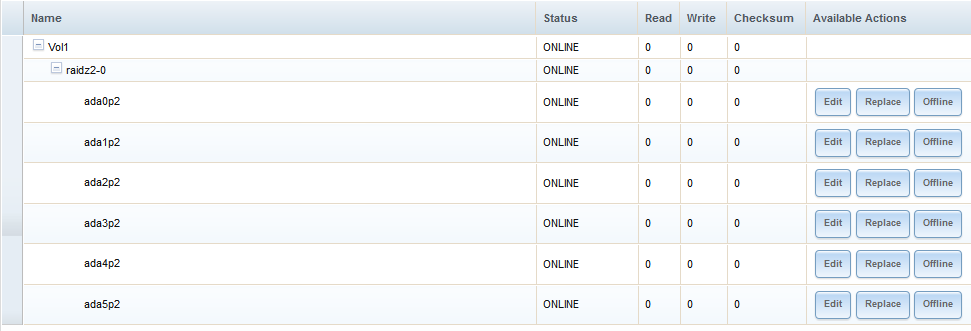

All 6 drives are in the same ZPOOL. I'm thinking I should find an internal 6 port SATA card and move all the drives off the motherboard.

You are missing the point all together. If you did exactly as I said in posting #61 above and that includes the last two sentences and that last item didn't report the drives as sleeping (to which you indicated in posting #62 that it worked), then your problem has nothing to do with your controller, your pool, or anything other than your last two drives are sleeping even though you have FreeNAS set up to disable sleeping. This could be a setting for the drives in the firmware or have you looked in the BIOS settings to see if you have a sleep setting for the drives?
Do this for me and post the results please, I want to see what the drive data is, maybe it can sort this out:
smartctl -a /dev/ada0
smartctl -a /dev/ada5
And here is the fix if you know your drives are spinning all the time and you have no intention of them sleeping:
Locate the code for chkdrive and remove the "-n standby" from the smartctl line as indicated below...
chkdrive()
    smartctl -H -A -l error -l selftest ${drivepath} >> ${logfile}
By removing this section of code (as indicated within the code notes) it will not wait for the drive to come out of sleep/standby and if the drive is actually sleeping, it will spin up.
There is no need to change your controller or uproot your drives. Let me know if the code change works.
