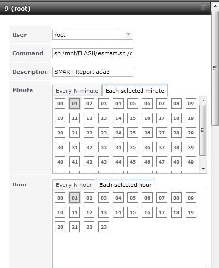

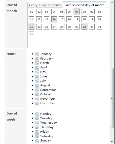

Now we will create a CRON so this script runs once a day, you can chose how often you want it to run.
12) Open FreeNAS GUI
13) On left side window click on System, Cron Jobs, Add Cron Job
14) Use the following settings:  (You may set the time intervals to whatever you desire)
  User: root
  Command: /etc/sh esmart.sh /dev/ada0
  Description: ada0 SMART Results
  Minute: Each selected minute: 01
  Hour: Each selected hour: 01 (checking at 1 AM)
  Day of month: Every N day of month: 1
Leave the rest at the default of all checked and click OK.
15) Add additional Cron Jobs for each additional drive you have.
16) Sit back and watch the reports come in.

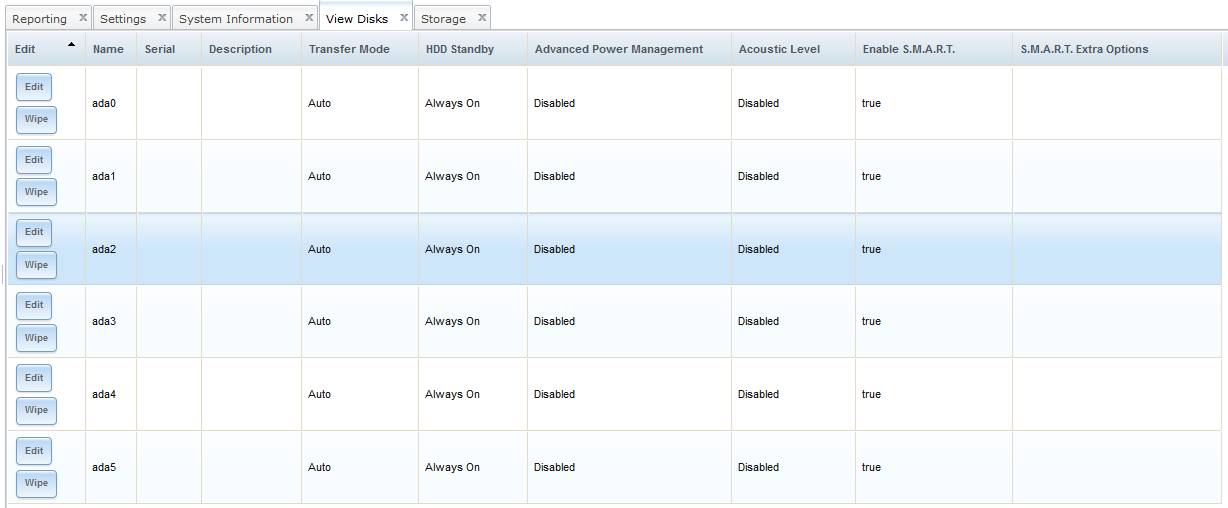

Again, the '-n standby' will cause an issue at the point where a drive not spinning is encountered.  Since I have a single pool of 4 drives, should my first drive exit due to not spinning, I can safely assume my other drives are not spinning either since I have the same HDD Standby (in FreeNAS GUI) settings for each.
