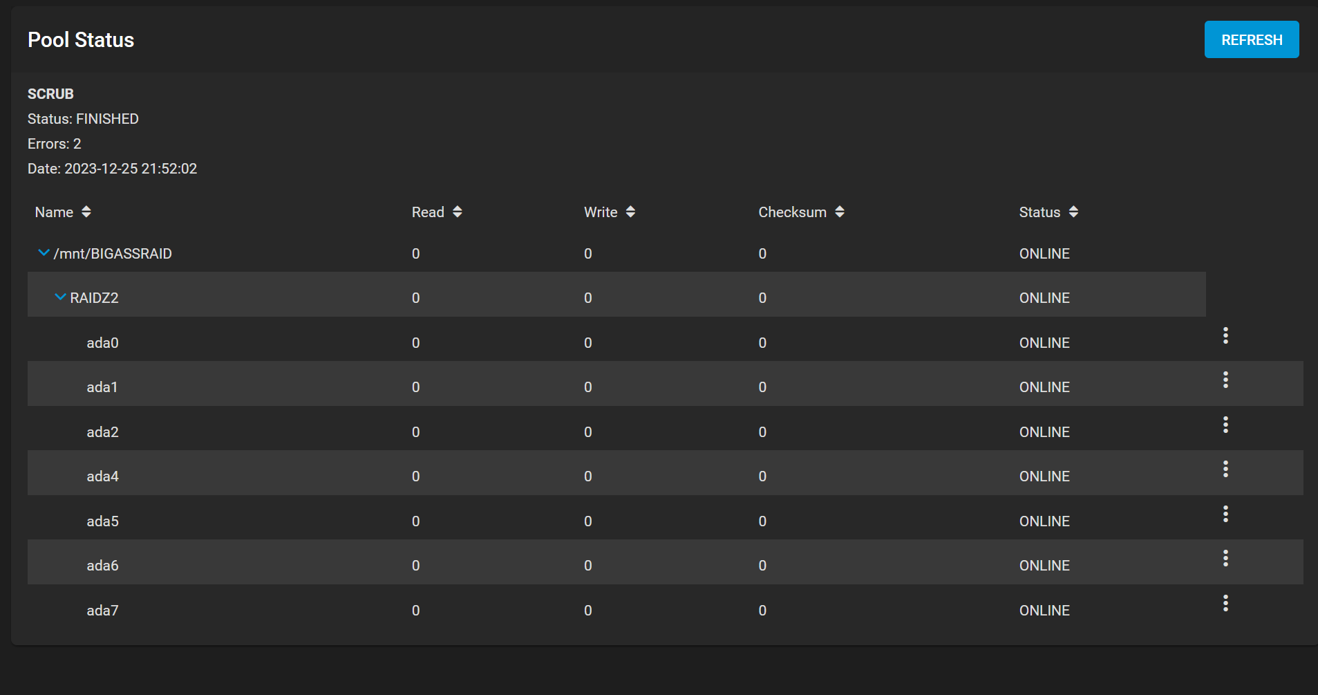

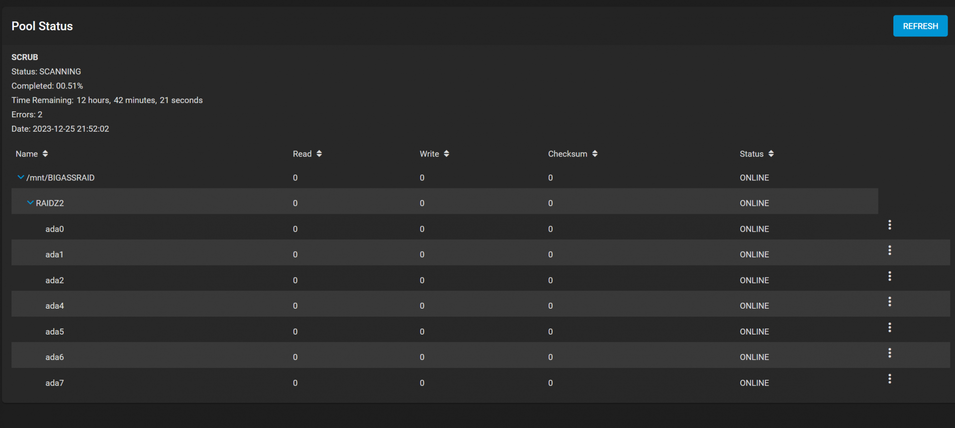

I am running a scrub as per your instructions. It will take some time for it to complete.
Apparently there were two errors there from the last scub on the 12/15/23. Again , all smart long tests were good free of errors.
After the scrub runs, what should I do? Also, should I check to see if the pool flags can be upgraded via the Storage tools? Wondering if the reason why the pool went offline was because of an incompatibility of pool flags and software updates?

Will do. I have to build another Box so that I can back up my back up. Before I closed this out as solved. I just finished the Scrub. How do I investigate those 2 errors? Do I need to be concerned?

root@freenas:~ # zpool status -v BIGASSRAID
  pool: BIGASSRAID
 state: ONLINE
  scan: scrub repaired 0B in 12:50:50 with 2 errors on Tue Dec 26 10:42:52 2023
config:
        BIGASSRAID                                      ONLINE       0     0 0
          raidz2-0                                      ONLINE       0     0 0
            gptid/1cc4ce99-7c53-11e7-85fb-e0071bff267e  ONLINE       0     0 0
            gptid/1d45eb56-7c53-11e7-85fb-e0071bff267e  ONLINE       0     0 0
            gptid/1dce4f37-7c53-11e7-85fb-e0071bff267e  ONLINE       0     0 0
            gptid/1e4d4aee-7c53-11e7-85fb-e0071bff267e  ONLINE       0     0 0
            gptid/1edd586a-7c53-11e7-85fb-e0071bff267e  ONLINE       0     0 0
            gptid/1f7159ec-7c53-11e7-85fb-e0071bff267e  ONLINE       0     0 0
            gptid/1fed78e0-7c53-11e7-85fb-e0071bff267e  ONLINE       0     0 0
