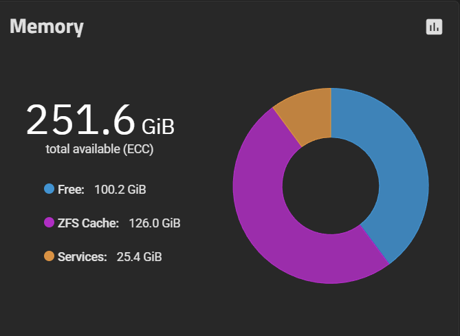

I have 256GB of RAM in my system. What should I be setting this to?
# system advanced update kernel_extra_options="zfs_arc_max=47191459840"
I think 32GB of RAM is plenty for services:
probain
Feb 25, 2023
211
That/his example would be ~43.9GB
Use this bytes converter, to get a reasonable value corresponding to how many GB's you want to allocate for ARC. Just give yourself some breathing room, if something would need to claim extra RAM somehow.
But be aware, that this tunable doesn't seem to work quite as intended. Especially if you use VM's in Scale
Update: I re-read the question :)

probain
Feb 25, 2023
211
JIRA: NAS-124864
I've now written down my train of steps, showing how I believe that this kernel_extra_options isn't working as intended/expected. And also how the VM's and middleware are affecting this behaviour. I do not know if it's all related, or if these are two separate issues. But that will be up to the great devs to decide :)
