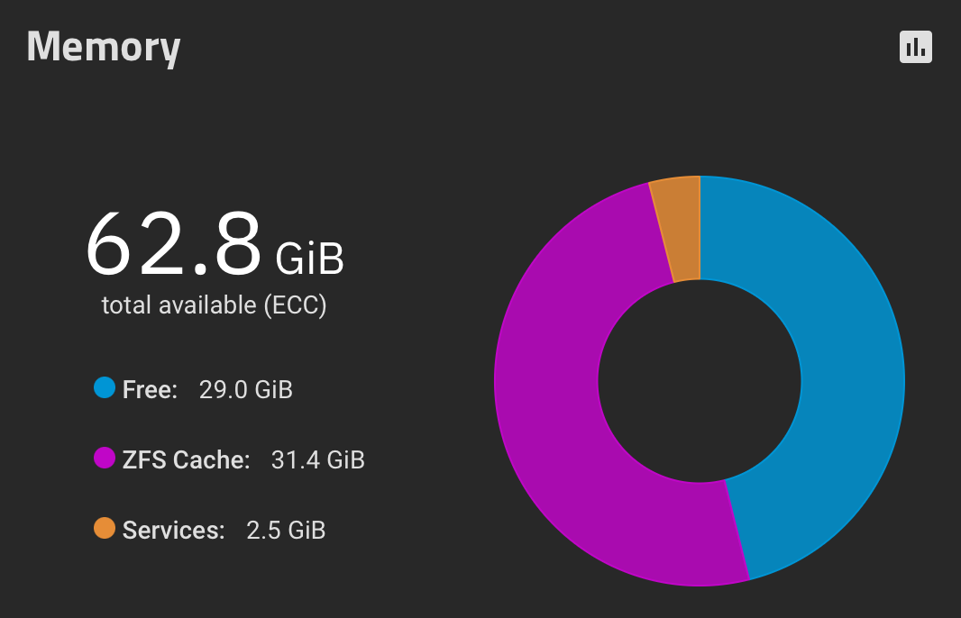

pixelwave
Jan 26, 2022
174
The command outputs "0" in my VM running on Proxmox
admin@truenas[~]$ cat /sys/module/zfs/parameters/zfs_arc_max
0
I am running only TrueNAS Scale as NAS, no VMs, no Apps. I currently have 64 GiB assigned from the Proxmox host machine:
I would like to increase that to use more like 75-80% of RAM?
fa2k
Jan 9, 2022
34
0

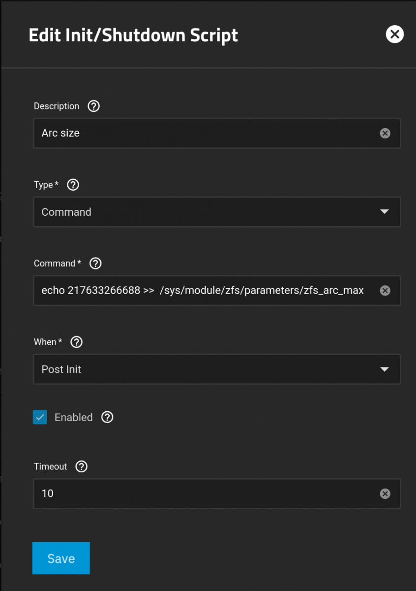

The pie chart is not necessarily a good representation of the actual usage, as it doesn't account for fragmentation. That said, if you want to experiment with increasing it, this is what I do:
Go to System Settings, Advanced, and add an Init/Shutdown script. Then you can add a command to set it when you reboot:
