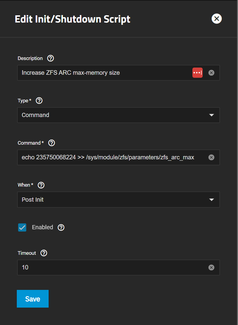

Your ticket shows using the postinit method. You have to reboot after applying that method and you also must select postinit as when to run so it runs after boot but before the services start.

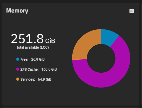

When I apply the setting I use for my system, I go from about 62GB (50%) for cache before applying the new value, to 82GB cache which is what I set my value to, after reboot.
I also noticed you are setting to 90GB which is less than 50% of your 256GB You can do that but still need to reboot.

I am aware that the "postinit" method as you call it "works". Although I use it with Cron, due to it being reset when VM's turn to an off state.
But I wasn't aware that a reboot would be necessary for the kernel options to be applied. I will try this later tonight, when I'm back home. Although it was stated by Honeybadger that adjusting zfs_arc_max could be done dynamically. And I then assumed he was regering to the kernel options method.

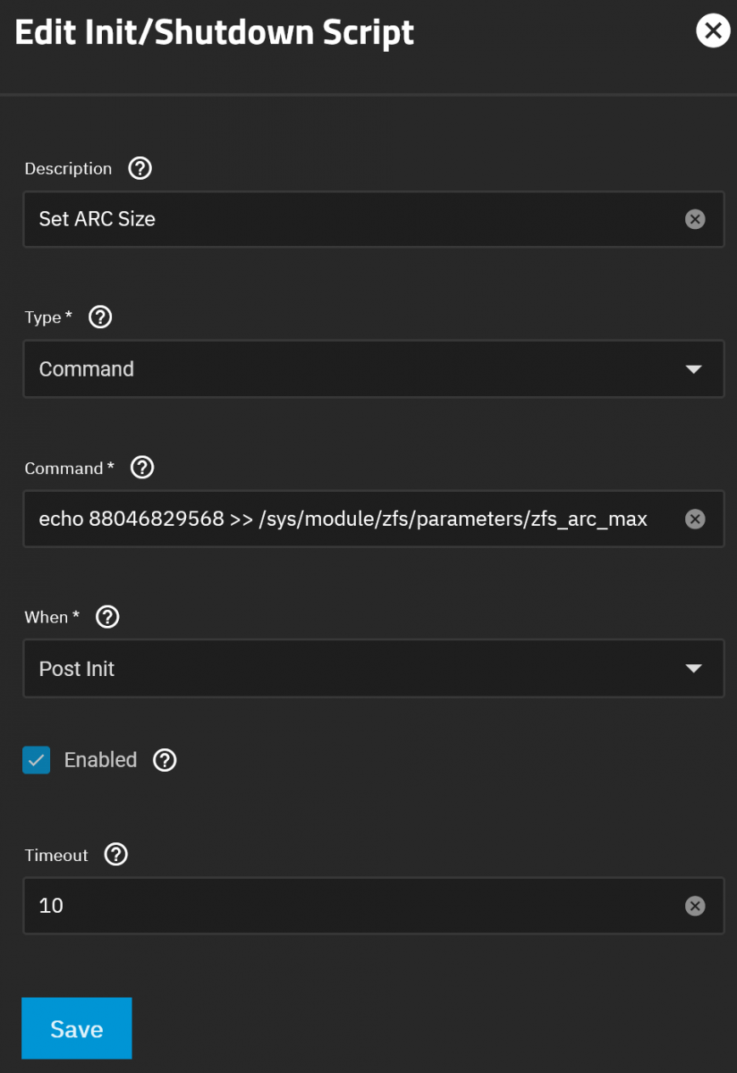

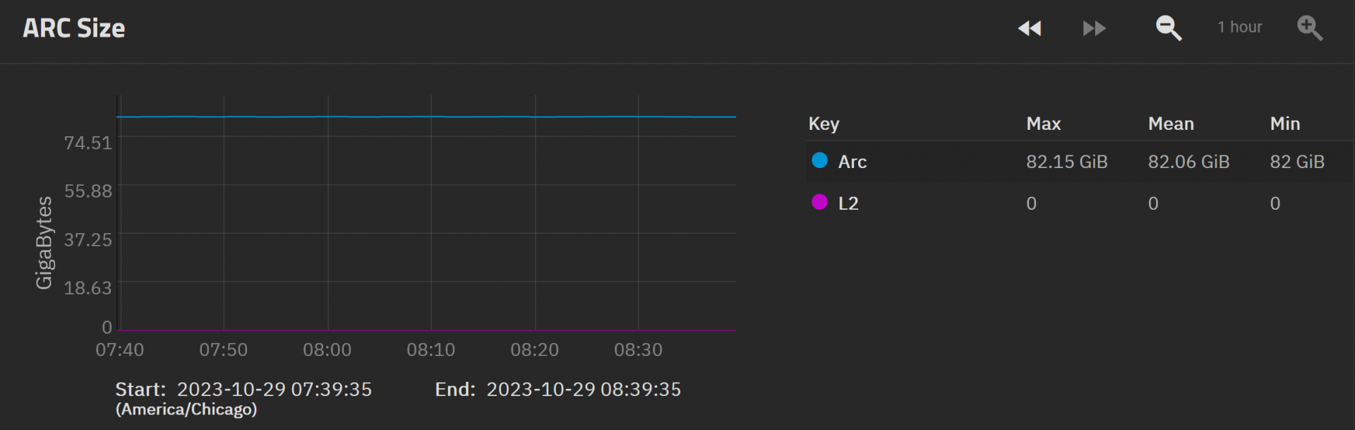

Yes. Mine went from 62 to 82 as you can see below [Edit: I should say I changed the value from 62TB which is the default value on my system (50% of 128GB memory) for ARC and changed the value to the byte equivalent of 82TB. When done with the change I rebooted the server for it to take effect. I do not know and did not care at the time what the original value internally was. You can guess that it is the byte value of 62TB and be close. The method I took (making it a command to run postinit from system > advanced menu). As the command is altering a value but not permanently changing it, I can simply remove or disable the command and all is back to default after a reboot The command I used (128GB total ram) is:
echo 88046829568 >> /sys/module/zfs/parameters/zfs_arc_max
and is shown below.

This adjustment to my systems ARC was done on a new setup during testing before being released for production. It worked fine in testing for the intended purpose of the server and is rock solid in production. The server has now been in production for a couple weeks, and the one it replaced (QNAP) is now out of service so I'm not willing to play much with settings, do reboots, apply new releases right away, etc. on it for the sake of playing with it as that is not good policy. ]

I did it the same way you did. Looking at the reports page. :smile:And looking at the pie-chart diagram on the main dashboard, gives an imediate and simple way to see if the ARC grows or not.

Here are some pictures to help others out for my 256GB of RAM:
# This is for 256GB of RAM with only 32GB left over.
echo 235750068224 >> /sys/module/zfs/parameters/zfs_arc_max
