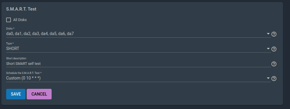

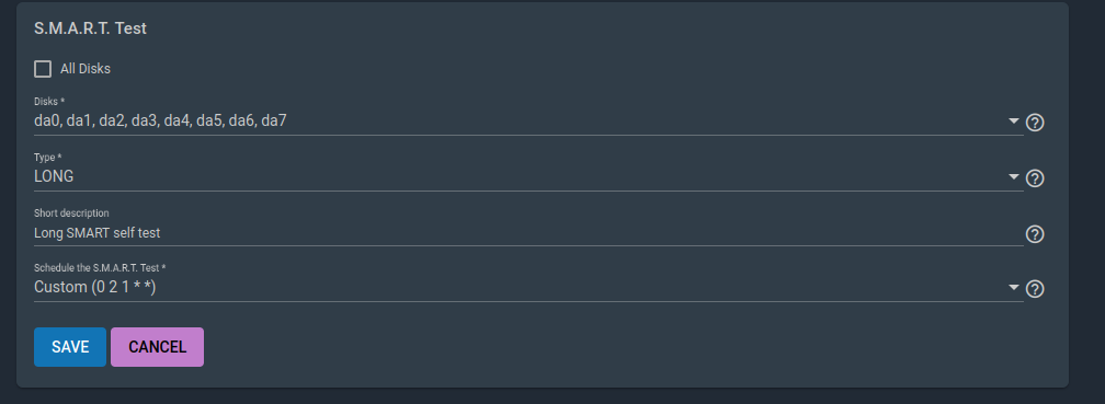

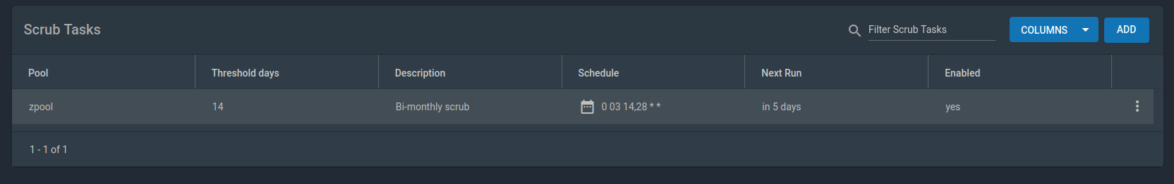

freenas-supero
Jul 27, 2014
128
I suspect the 2735 days without logging a smart test is because there is a read write error in the drive's smart log itself. Which would prompt me to replace the drive as you wouldn't get a warning before it just flat-out dies. @freenas-supero when you have time, could you please post the smart info from one of those 2735 issue drives in code tags?
See screenshots for SMART tests. Of course I have been running SMART tests periodically since this server has been built around 2014. Longs are done monthly on 1st day at 2AM. Shorts are done daily at 10AM. See screenshots. I hope my schedules are good cause its always a bit of a puzzle with CRON....... If anybody spots something wrong with my settings, please let me know! :oops:
For the SCRUBs, they're done roughly twice a month (every 2 weeks/14 days). See screenshot.
9 Power_On_Hours 0x0012 089 089 000 Old_age Always - 83427
                                                   ^^^^^^^^ - 83427 power on hours...
# 1  Short offline       Completed without error       00%     17584         -
# 2  Extended offline    Completed without error       00%     17470         -
                                                           ^^^^^^^ - Last extended test 17470 hours...
They're not actually happening. :frown:

Question 3: The scrubs are done regularly. Never got a data error from them. Is it safe (but not smart...) to assume that because the scrubs happened regularly with no errors that the drives are still "reliable" to a certain extent and still good to use?
