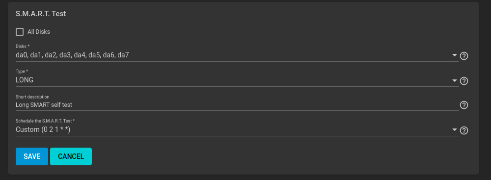

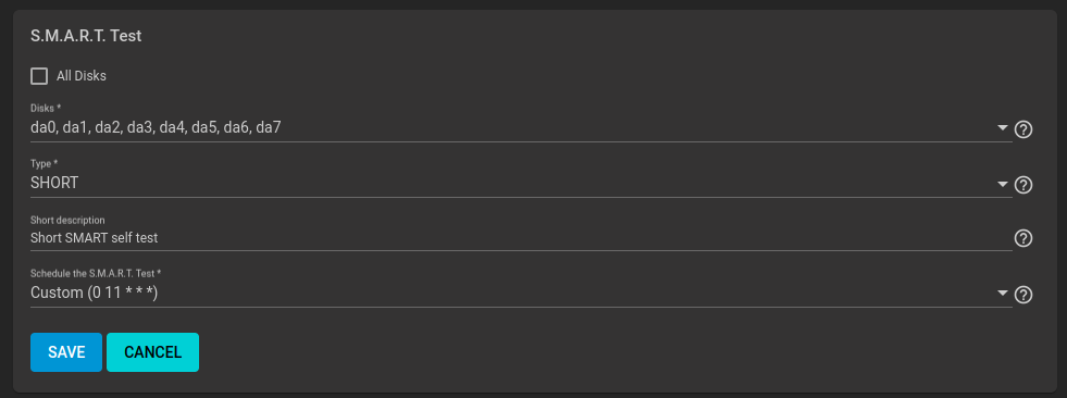

See how "Poweron Hours" and "Last test age" were reset to ZERO. Note that I already posted on this forum about the high value of last test age but never got a solution for this (see this thread). The Smart tests (long & short) are being run on a regular basis as per attached screenshots...
I have a feeling this is only a firmware reporting bug of some sort but I want to make sure..... Of course I have multiple backups... :) Should I worry about that specific drive (da1)?
