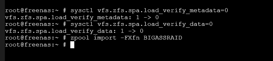

bent98
Jul 21, 2017
171
Bad block pointers and attempting pool rewind already. That's not a good sign for the health of the pool I'm afraid.
Set these two sysctl's to speed up pool rewind on import
sysctl vfs.zfs.spa.load_verify_metadata=0
sysctl vfs.zfs.spa.load_verify_data=0
then do zpool import -FXfn BIGASSRAID and after some time it should kick back
Would be able to return pool to its state as of (INSERT DATE AND TIME HERE)
Would discard approximately N seconds of transations.
Make your judgement call if you can live with that, then issue
zpool import -FXf BIGASSRAID
If it imports, reboot the system through the webUI, make sure your pool re-imports automatically, and fire off a scrub.
Best of luck.
I assume I need to wait before I can do zpool import -FXf BIGASSRAID ?

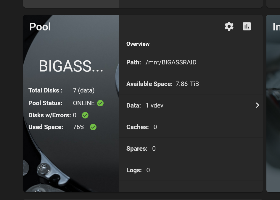

the dashboard is already showing this: I am afraid to look at the drives until I get a response from the shell.
Davvo
Jul 12, 2022
3,222
From Zettabyte File System to Jesus File System: BIGASSRAID, rise up and walk!
Your pool is, apparently, online. Backup immediately.

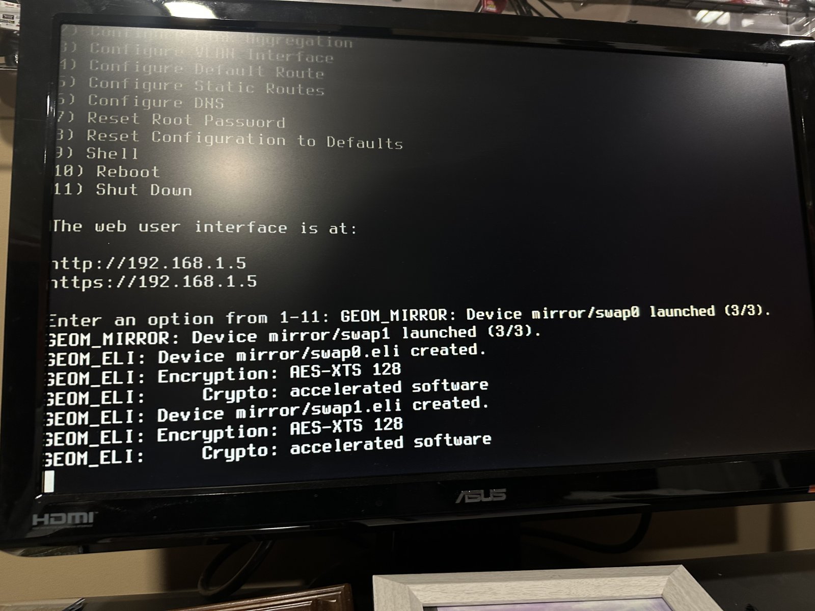

My computer that I was shelled into the Turnas server rebooted . I hope that’s ok as I lost my shell connection . The physical TrueNAS server screen looks like it’s still doing something. See attached.

Joe and Honey in their previous post suggested for OS to respond the below: I assume I shoudnt do anything until that happens even though pool shows online?
and then after that I have to issue this command
zpool import -FXf BIGASSRAID and reboot and scub
