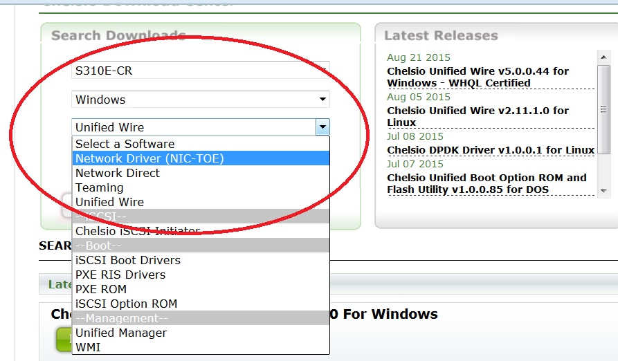

The NICs arrived today so I installed them into the FreeNAS server and my Windows 7 box. The install was practically effortless. FreeNAS immediately recognized the card and gave me a new cxgb0 interface. I downloaded the Windows drivers from Chelsio's support site and installed them with no trouble.
@Pheran
I was wondering which driver for Windows 7 that you used. There seems to be more than one...
Here's a screen shot (click the tumbnail) of the websites choices
Thanks for posting this, I was inspired and just purchased two cards complete with tranceivers today :D

@Pheran
BigDave, I used the NIC-TOE driver because it appears to be more recent than the Unified Wire version. But I managed to scrounge a different 10G NIC so I'll probably be pulling the Chelsio out of my Windows box pretty soon in an attempt to solve the no display after sleep problem I described in an earlier post.
You're not kidding, the unified driver is from 2009 :eek:
When I purchase a managed switch (next purchase) with some SFP+ ports, my goal is to hook my desktop and the FreeNAS server with fiber cable and soon add my sons desktop after
getting mine all configured. Thanks for the driver heads up, I'm just trying to have everything I need (driver) when the hardware is all purchased. I hate waiting to the last minute ;)
