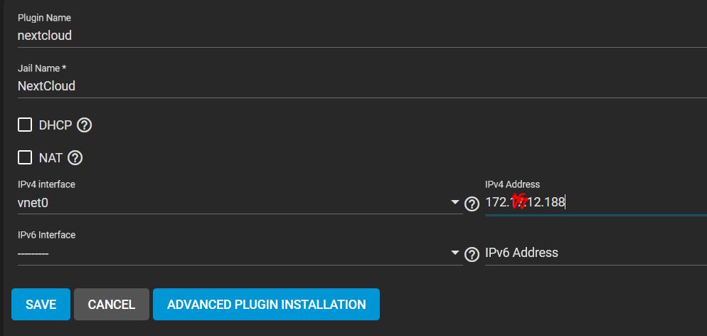

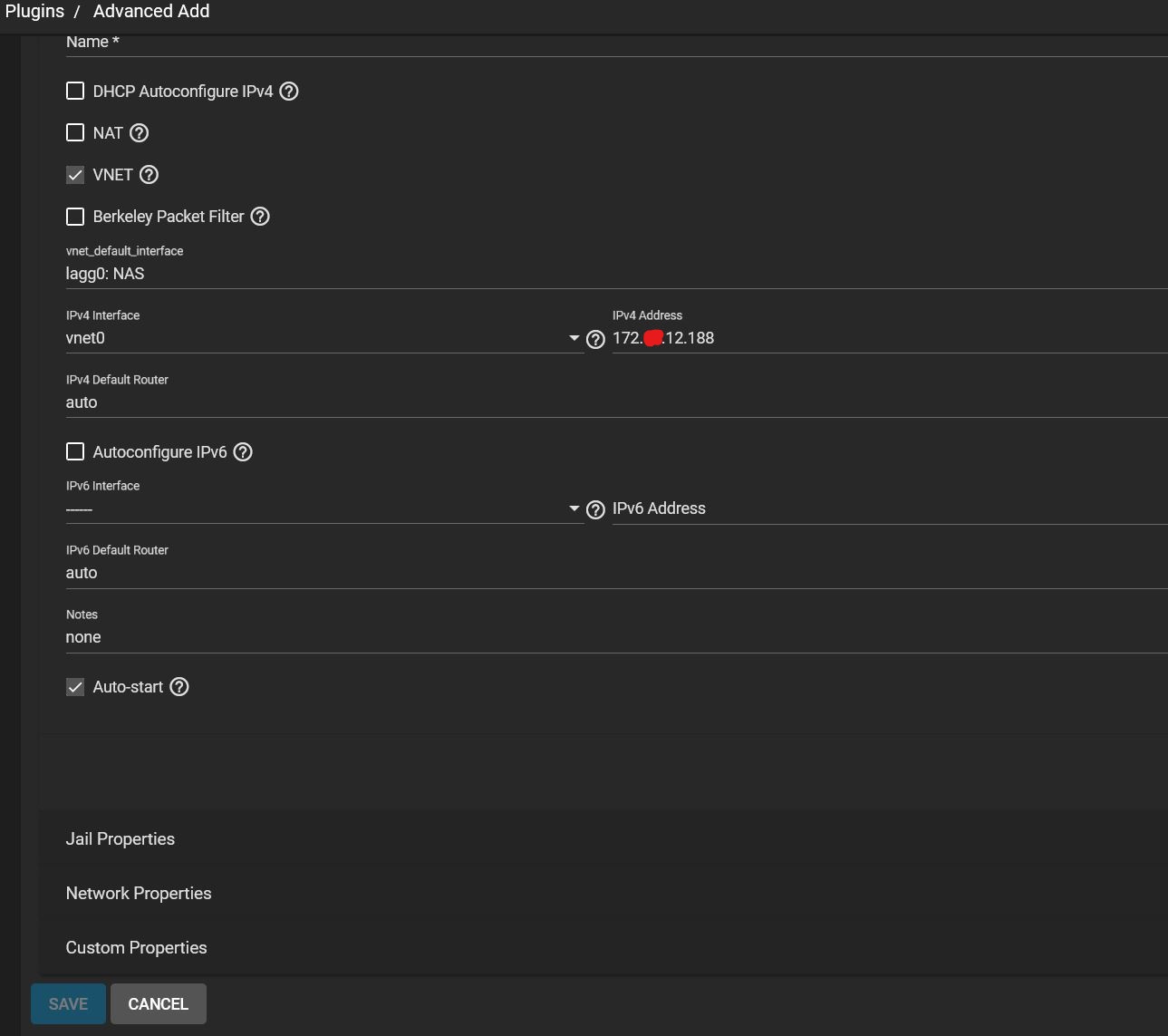

My requirement is to add another plugin Nextcloud to the same IP range as the lagg interface (172.x.12.188/25- Static) and I seem kind of stuck on the networking configuration. I was adding the network with the basic options and once I press save the system goes offline and the only way to bring it back is to disconnect the cable to igb2. (Most likely a loop due to both using vnet0 ?) Trying to add this using the advanced options is not successful since the save button seems to be greyed out.
Any suggestions on how I can achieve this.
