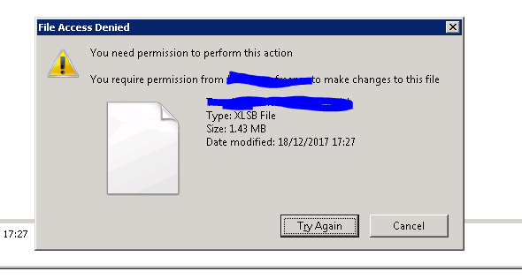

  1. Go into the FreeNAS SMB share using windows explorer, right click, properties and choose previous version. Open the time period I am looking for.
  2. Once there, I select the file, then copy and paste it to a location on the Windows Server.
  3. Error message appears saying "You need permission from "Some user" in order to modify this file". I am that user it is asking for.

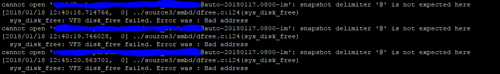

  4. I notice the attached error in the log file at /var/log/samba4/log.smbd
This is on a Server 2008 R2 that we get the errors mentioned in step 3 and 4.
However there are two work arounds:
  • It works using a copy command through the Windows command prompt and copying the URL from explorer, on the same server.
  • It works from Server 2012 R2 or Windows 10.
The fact that it works on Server 2012 is odd, but so is the fact it works through the command prompt and not explorer. I was definitely leaning towards it being a Windows issue along the lines of SMB version (SMB1.0) because I noticed that in 11.1 update that the "minimum/maximum protocol level" drop downs were removed. However I tried setting "server min protocol = SMB2.0" in the share's auxiliary parameters box but this didn't make a difference. Also seeing errors in the Samba log file also make me question which side it is.

There were some changes in Samba's VFS layer that required some changes in this VFS module. zfs_space gets the used/available/etc from ZFS rather than using samba's internal dfree.
This should be fixed in 11.1-U1. If you don't mind, can you upgrade to latest version and try to reproduce?

Unfortunately the update does not fix my issue, is there anything I need to do after upgrading?
Excellent. I think you've found a bug in zfs_space or shadow_copy2. Under services->smb set log level to "debug", reproduce the problem, generate a debug (system->advanced->save debug), then attach it to your bug ticket. :)
