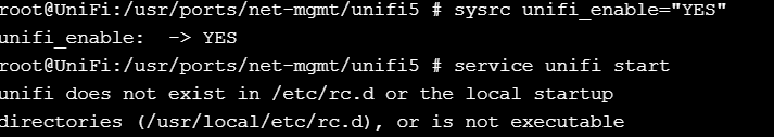

thejamesk
Member
Sep 2, 2018
67
Hi
Great guide and thanks for providing it @m0nkey_ !
Unfortunately after following the video twice I still get an error when trying to start the service. Can anyone help? :)
