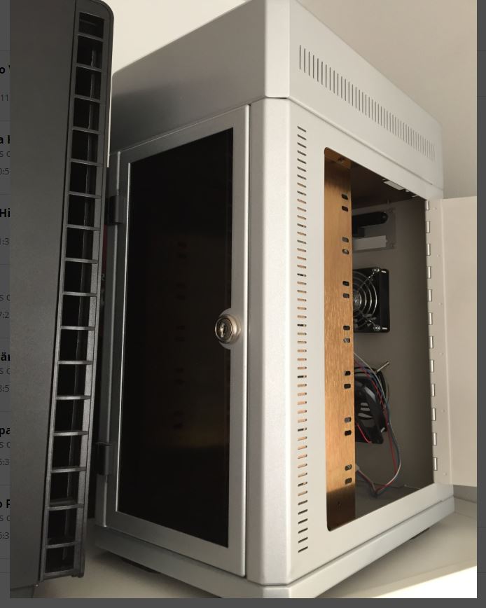

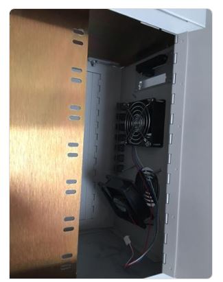

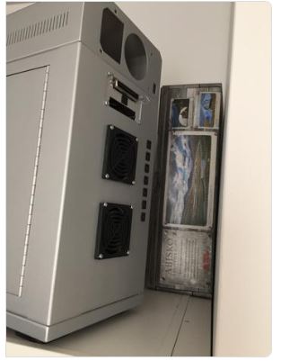

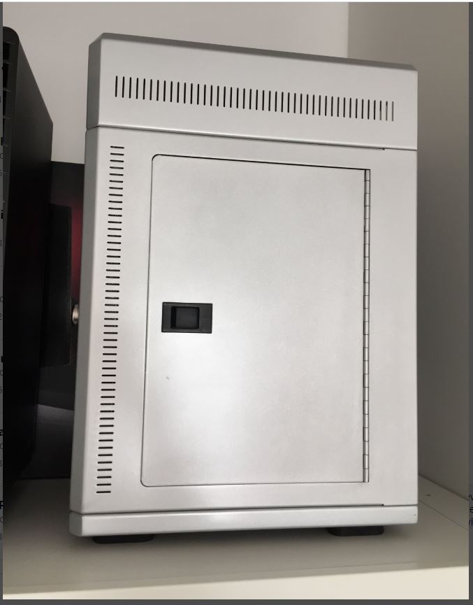

I would have an extra brand new 350W power supply and it's unused. The power supply for this standalone SSD is also connected to the UPS so power outage is very unlikely.
I will disassemble my original HP xw8400 Workstation computer and then rebuild it in the server custom cabinet shown. I've been thinking of this place all inside the cabinet in a separate SSD disk power supply.
PS: I sent a message to the Intel 320 40GB SSD seller via eBay on Ebay and I asked him for pictures with the test results, I can say for yourself the condition of each sector. I told him I wouldn't pay him until he sent me the test results to I see.
