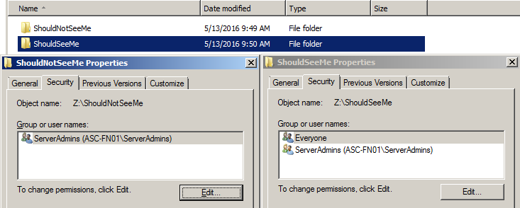

Are you taking about the entire share or certain folders within the share?
If you are talking about folders in the Share, simply map a drive to it (using appropriate credentials); Right-Mouse click on the folder and set desired permissions.
Here is a quick example:
For folder "ShouldNotSeeMe", I edited the permissions (from Windows) an simply removed everyone except for my Group ("ServerAdmins"). Now if any User connects to my share (called "Data") then they would only see one folder called "ShouldSeeMe".

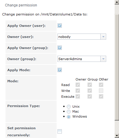

For example, I have one CIFS Share called "Data"; here is what the rights within FreeNas (on the DataSet) look like:
If I wanted to have a folder called "Backups" that only members of the group "Backups" could see/access I would simply create a folder on "Data" called "Backups". Then from within Windows Explorer I would set the "Security" so that only "Backups" have rights (remove all other Users/Groups... Well I would leave my "ServerAdmins" group in there too...). Later if I hire someone new and want them to get access to "Backups" I would simply create the account in FreeNas and add them to the "Backups" Group. *** Just only give them "Modify" and not "Full"... Don't want them to be able to change permissions or take Ownership... ;)
So from simplistic point of view everyone knows to either browse or map to "\\%ServerName%\Data" and they only see/use what folders they have rights to. No complications like having to know to map to different Shares, etc. Makes this all a "one stop shop".

I think you are over complicating things with wanting to create multiple shares. This will lead to a lot of "Administrative Overhead". Easiest way to do all of this is to make one share then connect to that share with admin rights. Within that make your folder(s) and set the rights on the folder(s).
