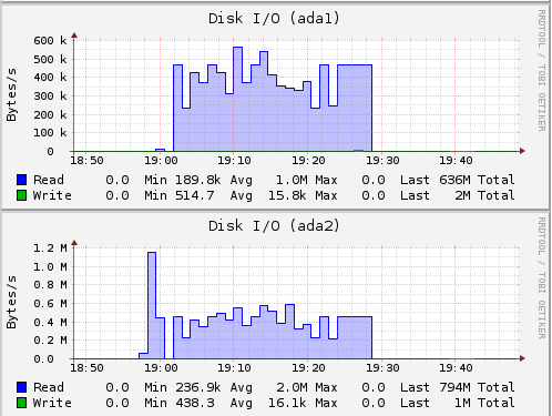

I've had miniDLNA running on my FreeNAS server (9.2.1.7) for a few weeks, with no issues. As of yesterday I've noticed that whilst watching 720p video, served by miniDLNA over wifi, I seem to occasionally get stuttering where the video pauses. This seems to coincide with FreeNAS disk reads.
Looking at the reporting, there seems to be reads of upto 1.2mb/s on my raid (mirrored) pair, when the stuttering occurs. Maybe not massive, but spikes relative to anything else (see attached). Are there any tools I can use to determine what process is reading the drive at this time? I'm not sure whether the disk read is causing the video stream to stutter, or if the spikes in disk activity are caused by stuttering video. i.e the WiFi dropping in and out and the client then rebuffering or something? Any help greatly appreciated. System is as below:-
