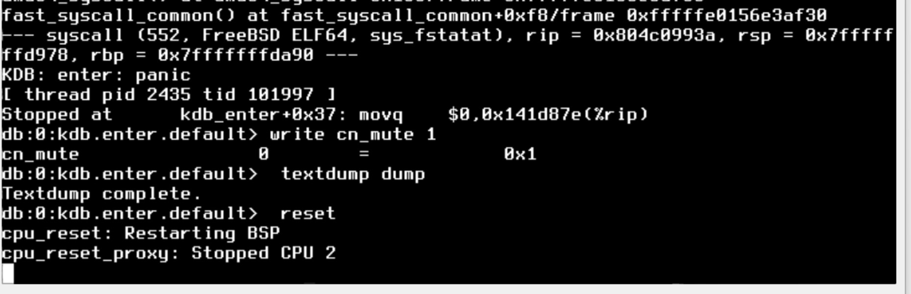

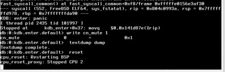

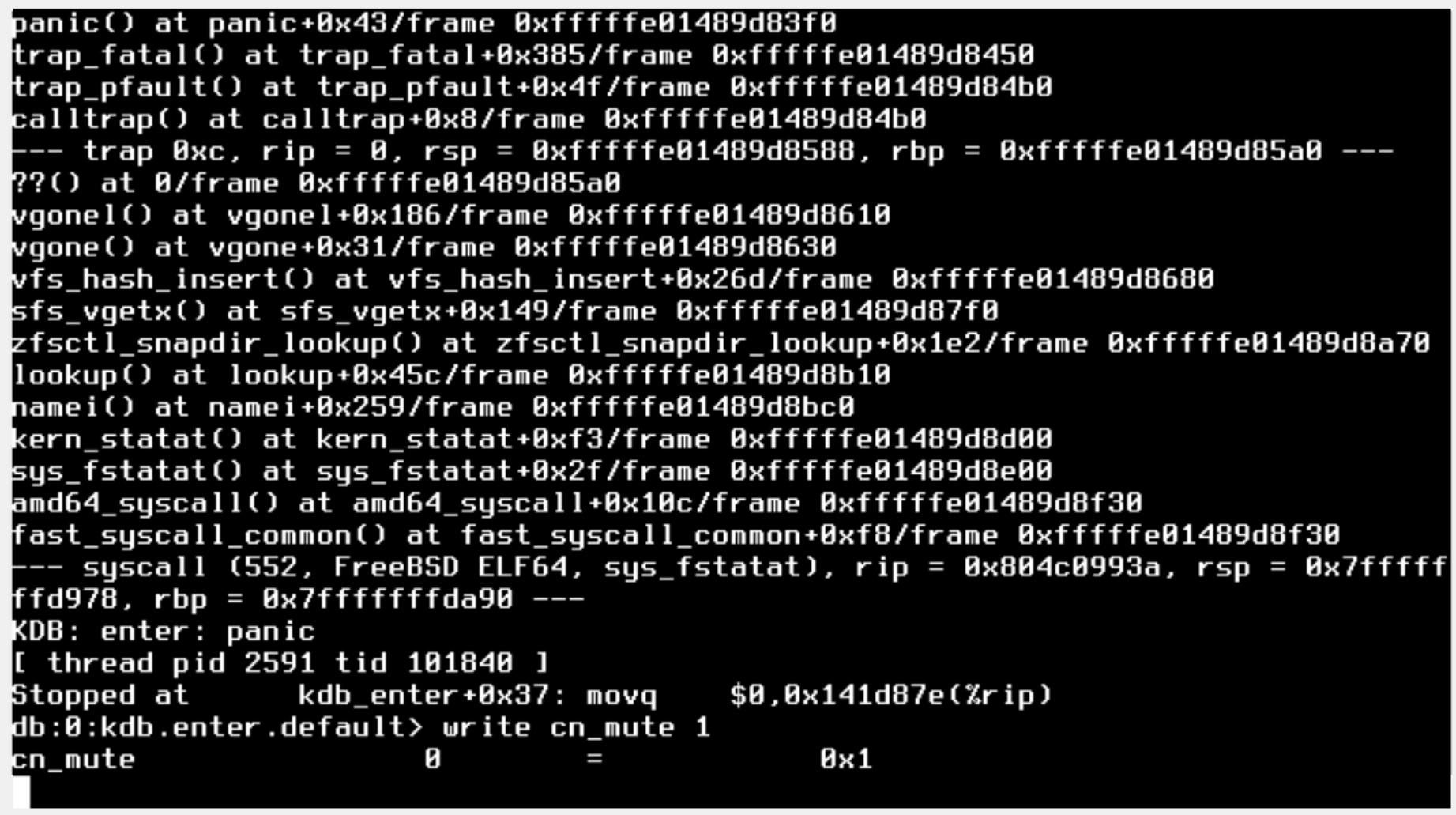

However, all of a sudden, navigating to a CHILD dataset, crashes my TrueNAS.
It is a sudden hard crash of the TrueNAS OS for some reason.
Attached 2 screenshots.
You'll notice the process IDs are different, that's just because I had to force this a second time to get the rest of the text.
