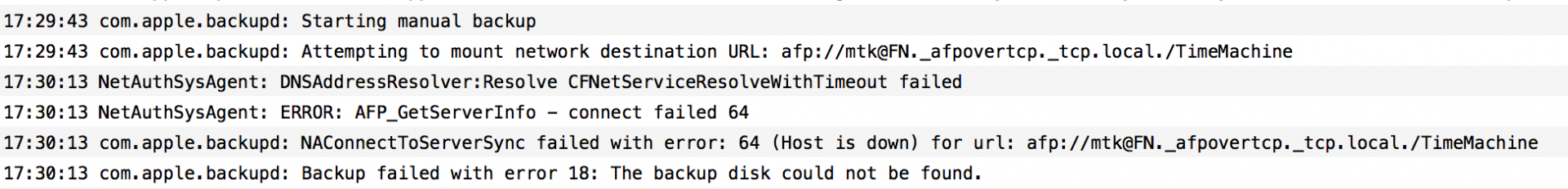

so... now backups see to work just fine, both manually ("backup now") and hourly started by the machine.
then I rebooted the Mac and:
MtK
Jun 22, 2013
471
Any ideas?

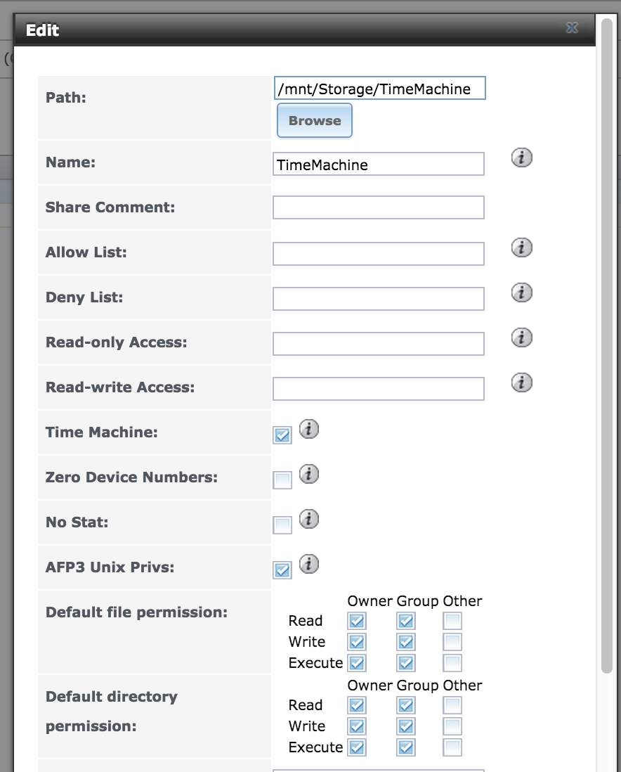

Post a screenshot of the share set-up from the FreeNAS GUI, like this one:
MtK
Jun 22, 2013
471
If it's not here already I'll post it later...
MtK
Jun 22, 2013
471
here you go
adrianwi
Oct 15, 2013
1,231
Not sure if it's necessary, but mine has users assigned and I'm not having any problems. Might be worth a try?
And although it's probably nothing to do with the name, I'd call the dataset something other than TimeMachine.

The error in the second post above look like some kind of AFP name service errors, which I don't know much about. But if you use the IP address of the FreeNAS machine in Time Machine (assuming it lets you) does this persist across a reboot? If so, it at least narrows the problem down. But not having the relevant user and group 'allowed' in the AFP share description may well affect this, as Adrian Williamson says above.

The group of users is set in the allow, I just removed it for the screenshot.
Don't forget we are talking about a single user here...

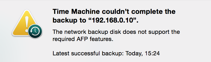

back to this, with a (somehow) new issue....

From my experience the latest Yosemite 10.10.3 does not find these settings. It does however find and backup to the shares created by the latest FreeNAS 9.3 wizard, which gives execute permissions to the AFP default directory.
adrianwi
Oct 15, 2013
1,231
No problems with my TM backups pre and post 10.10.3
