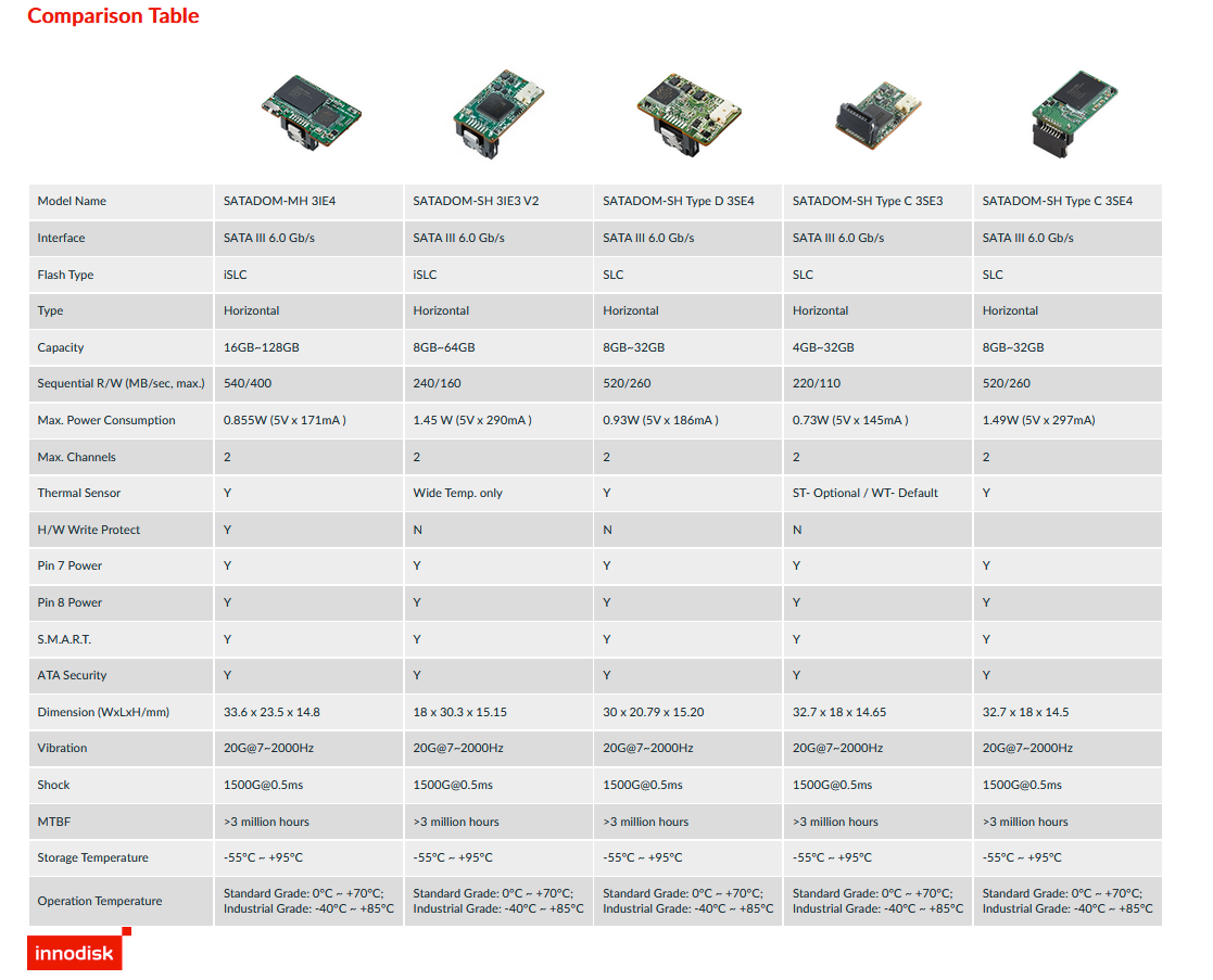

Zoltar
Feb 10, 2023
10
Good afternoon, I would also like to kick qts out of my house. Aside from the vulnerabilities and hardcoded credentials, I've been putting up with their bad software since the early builds of version 4 when there was a problem with the video codecs I think it was and they removed codexpack. I don't know how it behaves on other devices but mine has become garbage at all levels. The fact is that I have been thinking about changing it for TrueNAS for a long time, but I have not dared due to my limited technical knowledge, but the last straw is that they have disabled an old TwonkyServer license that I bought as a result of the problems that I have commented, they have left it useless. I have read all the threads but I have doubts about which SATADOM I should buy to change it, use Core or Scale and which version. My model is a bit old, the TS-453PRO with a TR-004 expansion box, and I can't find which eUSB it takes exactly, although I've already read that I need a 16Gb one and better if it's SLC instead of MLC. I've found these: http://www.altec-cs.com/Distribution/IndustrialStorage/USB/DoM/SLC and
Could someone recommend which one to look for and where I can buy it (EU)?, I can't find it in any online store. And which is better to install, Core or Scale, and which version. The most current or an older one better? Thank you so much.

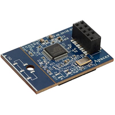

Jun 2, 2019
590
@Zoltar
Welcome!
Most QNAP units use a 512MB Apacer eUSB DOM, which is not large enough for TrueNAS (16GB minimum). The OEM eUSB DOM is 512MB, SLC, +5V, 10-pin (1 key), 2.54 mm pitch, 90 degree, with mounting hole. (data sheet attached)
The data sheet you included in your post is for SATA DOMs, which is a completely different form factor and is not compatible with QNAP internal eUSB DOM. The link you provided in your post includes the Low Profile (LP) version, which is a 2.0 mm pitch header.
Assuming you can even source a compatible eUSB DOM, you will have to take apart the entire chassis, use a heat gun (hair dryer might work) to soften the white staking compound, use a tool to remove the staking compound, pinch the plastic riser, then remove the OEM eUSB DOM.
OPTIONS
Assuming you don't have an internal M.2 or SATA port, your options are as follows:
1. Source a compatible eUSB DOM and replace the smaller OEM eUSB DOM (difficulty high)
2. Purchase an external USB SSD enclosure and SSD. (difficulty easy)
OTHER
1. CORE vs SCALE depends on what you plan to use it for, but don't expect a full replacement for QTS features (transcoding, etc.)
2. TrueNAS does not support expansion chassis like the TR-004

Zoltar
Feb 10, 2023
10
Good morning, Thank you very much for her answer. I am very aware of the compound that holds the plate, I have colleagues who have broken it when trying to replace it. Thank you very much also for the data sheet, now I understand the specifications type A, B, C, etc... I will review it in detail to choose the correct one. Then we'll see if I can find it.
My model does not have PCI for expansion, and I only have two free bays in the TR-004 (I have already read that it does not accept it, but I only have it with a couple of disks for backup that I also extract to an external usb disk) . The option of installing it on external SSDs doesn't really satisfy me.
I have already lost the QTS features, apart from the fact that the transcoding worked very badly for a long time, and I had disabled the video and photo station, when I got angry because they did not want to accept the license that Twonky paid for, I have deleted my account and the free Cayin license has also been permanently disabled. When I bought it, it used all the functions, File Server, Qsync, Transcoding, Video and Photo Station, Virtualization, Containers, iSCSI Storage, Backup of mobile devices, etc... the whole family used it, but over time I've gone disabling options due to poor performance, and I've had it for years without internet access, which makes it work even worse, QNAP has excelled.
Given the great experience that you seem to have, I would like to ask you a question. I had planned to replace the NAS with a more modern model, or mount a new chassis with SSD or NVMe, but due to economic problems in the end two WD failed and I changed the four disks. Currently I use it as Storage videos and photo family, FileServer, MediaServer, QSync for the PCs and mobile devices, and iSCSI Storage. If I manage to find the eUSB, and even if it's installing an older version of TrueNAS, will I notice the performance? I understand that apart from losing the transcoding I also lose the hardware acceleration of the raid, right? Thank you very much for your time, and for all the information in the forum, it is very helpful.
