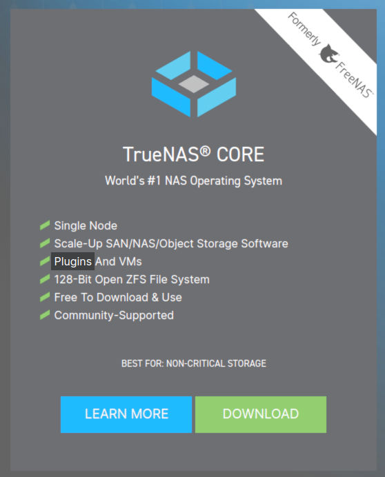

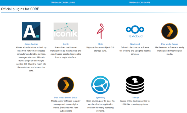

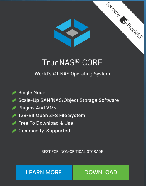

For the sake of consistent messaging, TrueNAS Core needs to drop all references to Plugins on its marketing and website, and replace it with: "Custom jails! Build your own FreeBSD jails to manually install and manage your own applications."
There's really no excuse for this. It's bad messaging. Harms the brand, and misleads new users.
Fine. Plugins are dead. Okay. But for the longest time this is what is being advertised in no subtle manner:
plugins-features-jpg.57375
plugins-main-page-jpg.57373
plugins-core-features-jpg.57374
official-plugins-for-core-png.57476
Those are all references to Core (not SCALE).
And to be clear, these have not just simply been on the website for the longest time... they're still there, even now.
