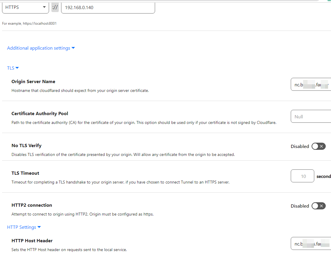

Thanks again. I changed from HTTP to HTTPS and added my subdomain.domain.com in the spaces under TLS for Origin Name Server and under HTTPS Settings for HTTP Host Header.

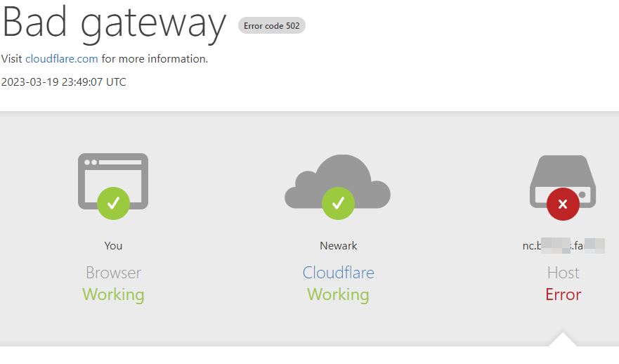

I am no longer getting the ERR_TOO_MANY_REDIRECTS error, but I am getting a 502 error that says the browser is working, cloudflare is working, but there is a Host error.
I did also add my internal IP for filecloud and my subdomain.domain.com to Trusted Domains in config.php for Nextcloud in the Jail.
Any idea what I still may need to change to get this to work?

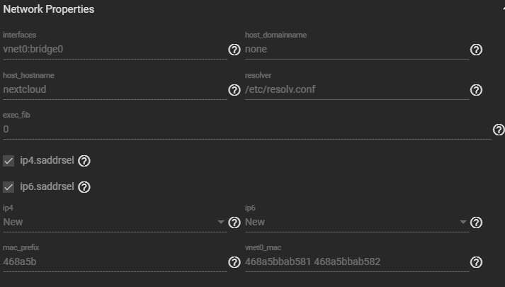

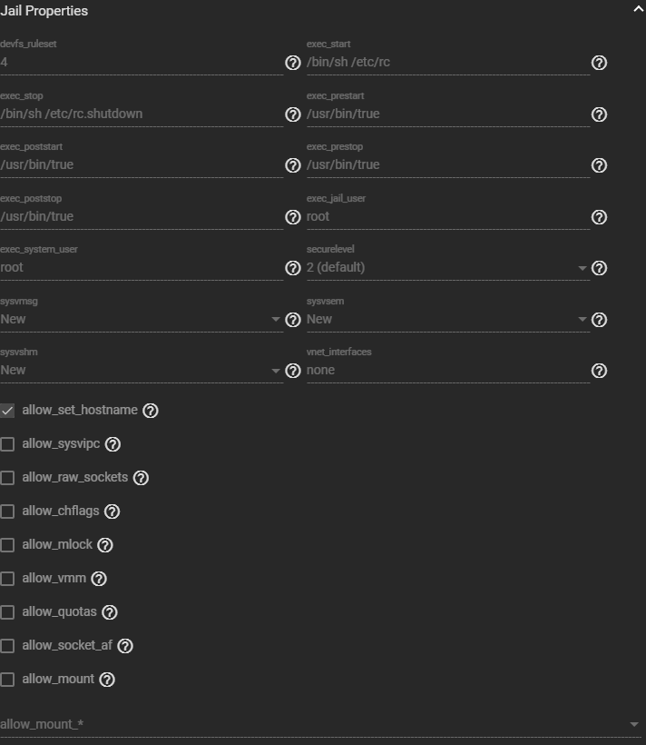

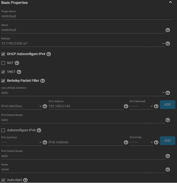

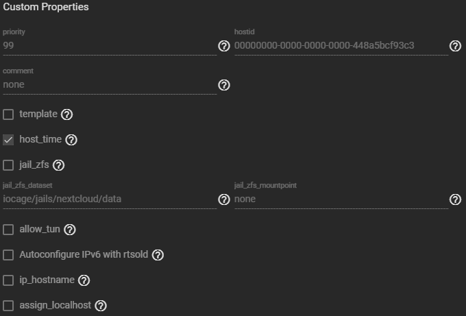

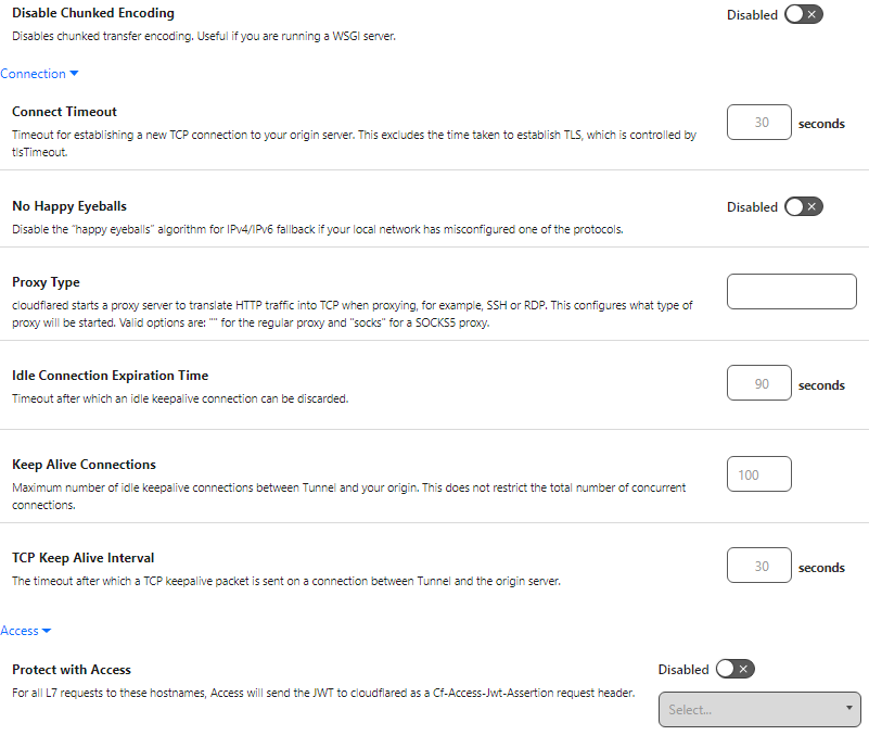

I really appreciate your help. In order to limit the back-and-forth, here are screenshots of my truenas jail and my cloudflare tunnel settings.
Here is the screen when I navigate to my subdomain.domain.com.

10
That worked! Thank you!
