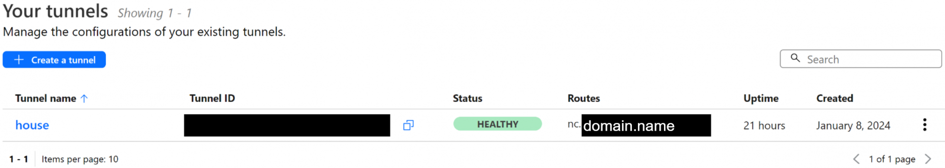

I added my domain to Cloudflare and I installed the Truecharts "Cloudflared" app on TrueNAS as the connector.
My SSL/TLS encryption mode is Full and I have Always Use HTTPS turned on. I also have "noTLSVerify" turned on under the Nextcloud Public hostname:
This exact setup let me access a Wordpress server and my Minecraft server online with no issues but my Nextcloud instance doesn't load. The Wordpress and Minecraft servers are both Truecharts but the Nextcloud app is TrueNAS official.

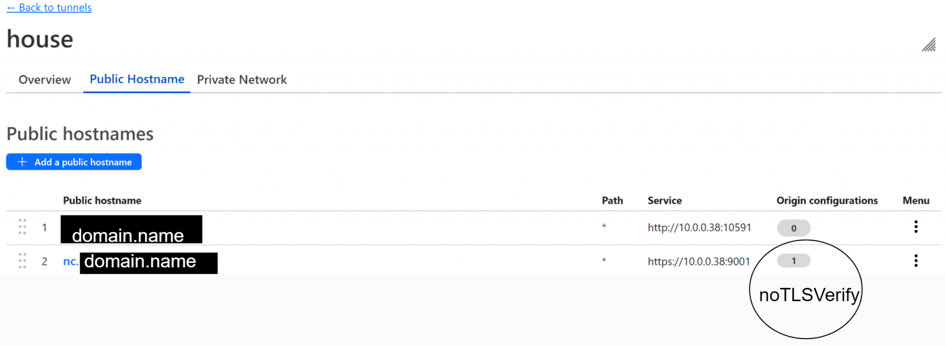

You might have an issue with your Cloudflare tunnel setup?
  • Make sure your SSL/TLS encryption mode is Full for your domain
  • In your tunnel config make sure your subdomains are on top of your main domain (like the last image in my first post)

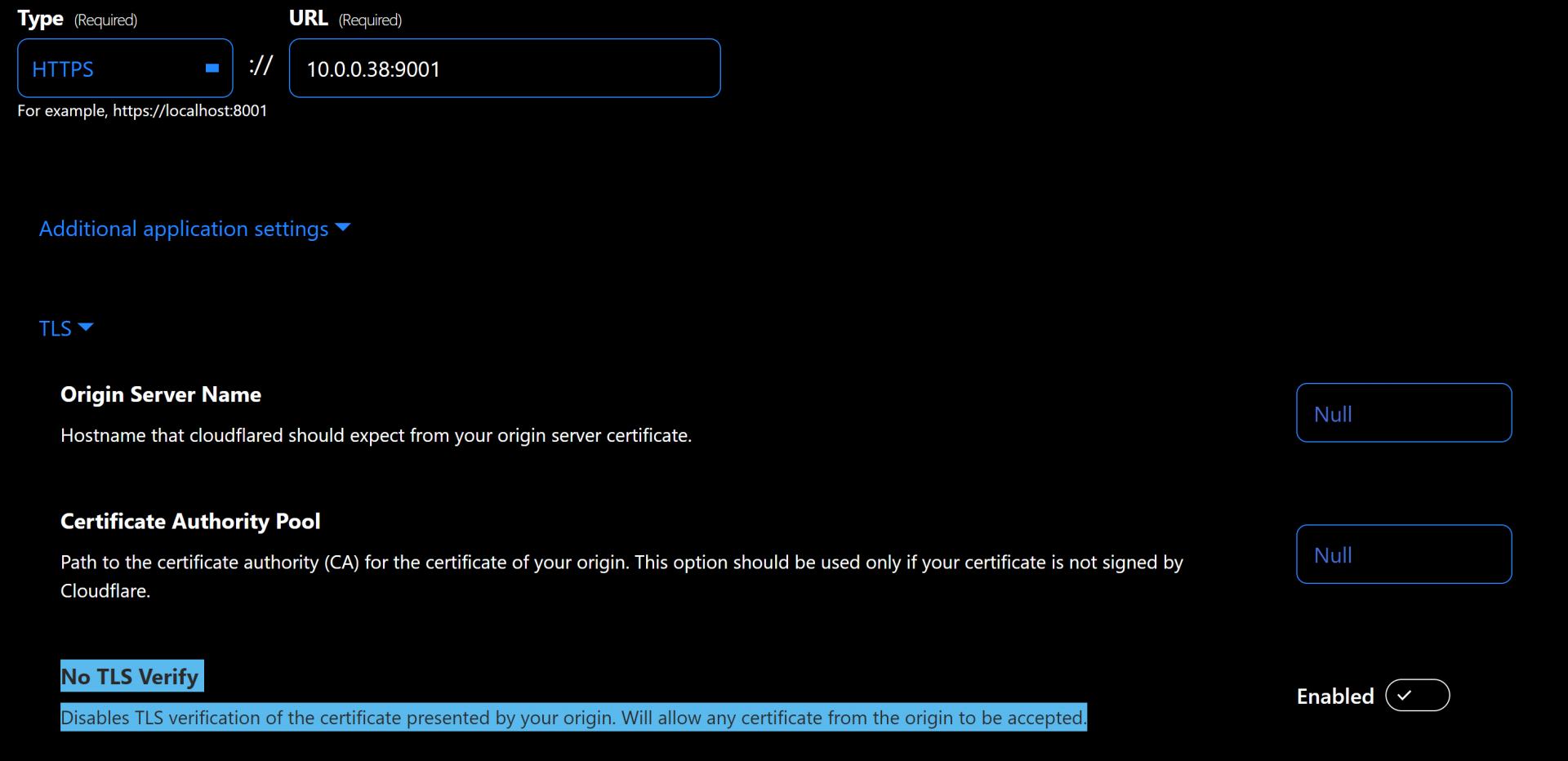

  • For subdomains using HTTPS like Nextcloud, make sure to enable No TLS Verify:

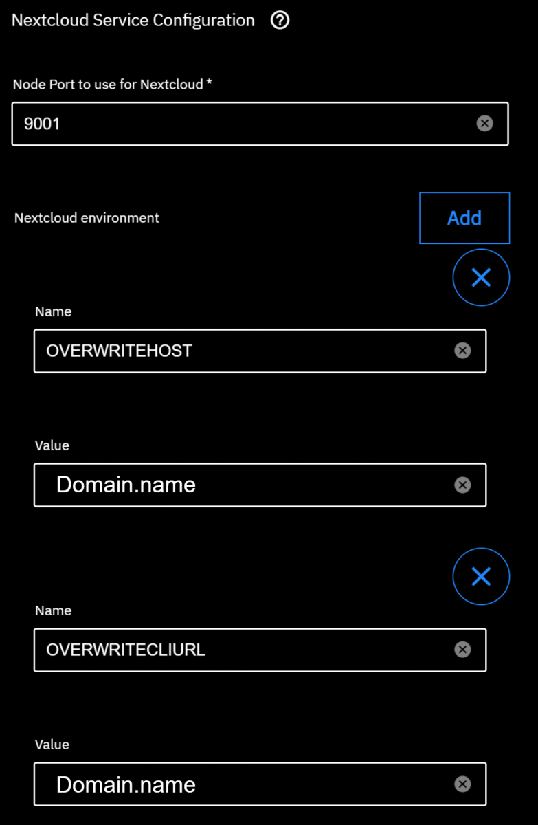

My Nextcloud install has the default certificate added, ffmpeg and smbclient installed, and cron jobs enabled. All pretty standard stuff. The only change I had to make was to add two environment variables under the service config:
I waited for the app to restart (or I might've restarted the server) and it just worked. I can access my Nextcloud instance from "https://nc.domain.name".
