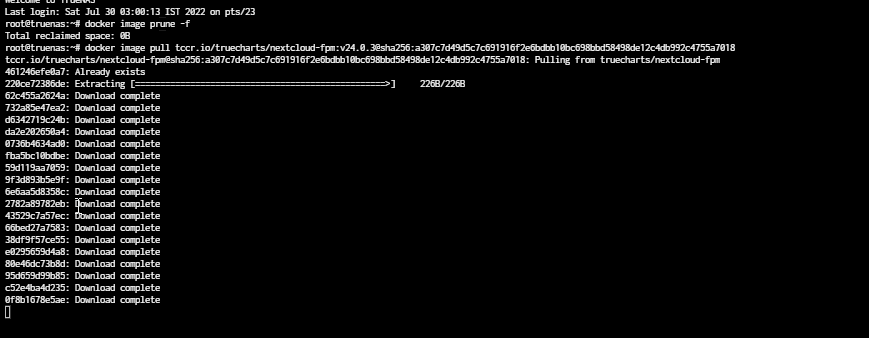

An alternative would be to use system shell,
execute
docker image pull
On the image that failed to pull
So that the image is caches locally
Then try to launch the app again, it should pick up image.
Also another thing to try would be to perform a prune with docker on stale images,
docker image prune -f
there could be checksum failure at local cache which caused the cancellation of container launch
mnbk91
May 23, 2022
9
It took quite a while and my gui shell kept disconnecting, got frustrated and ssh into my machine and pulled the image manually took around 15 mins to extract everything, but after that tried to install the nextcloud app from truecharts and it worked.
thank you very much man @aekt
