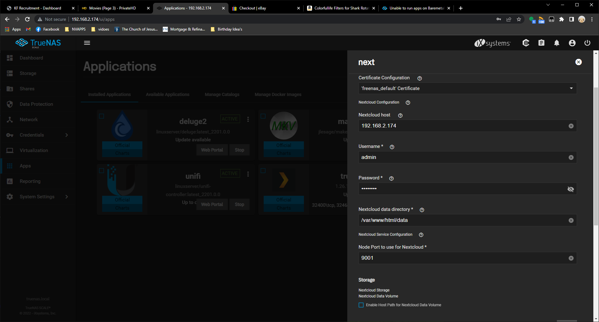

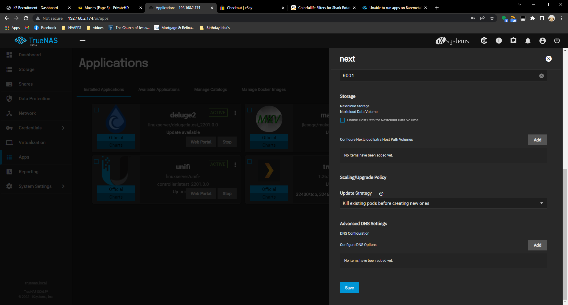

review you network config in the app your problem lies there. as for having all the answers some times you just have to mess around with your config to find out what is broken try to make config simpler. sorry you are having a hard time getting nextcloud to run

as stated above just installed and used default setting and it starts and works
