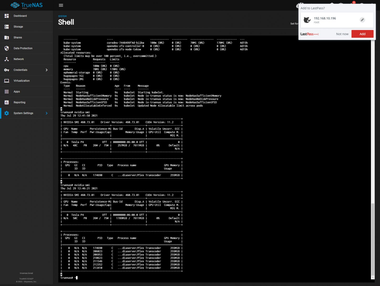

So just an update... Got Docker working with the Tesla P4 and Plex Transcodes, still cannot get K3s working correctly with it but still working on it. i had a lot of streams rolling with the transcodes it was pretty tight (see pics attached)
For those interested... Docker Run File is
sudo docker run \
--name plex \
--net=host \
-p 32400:32400 \
-e PUID=0 \
-e PGID=0 \
-e TZ="US/Central" \
-e VERSION=latest \
-e PLEX_CLAIM="claim-o4beDGGztYzKaBmkeQxH" \
-v /mnt/Test-Pool/Plex-Config:/config \
-v /mnt/Test-Pool/Transcode:/transcode \
-v /mnt/Test-Pool/Videos:/data \
-e NVIDIA_VISIBLE_DEVICES="all" \
-e NVIDIA_DRIVER_CAPABILITIES="compute,video,utility" \
--restart unless-stopped \
--gpus all \
--runtime=nvidia \
linuxserver/plex
and i followed instructions for upgrading nvidia drivers and then did the following..
