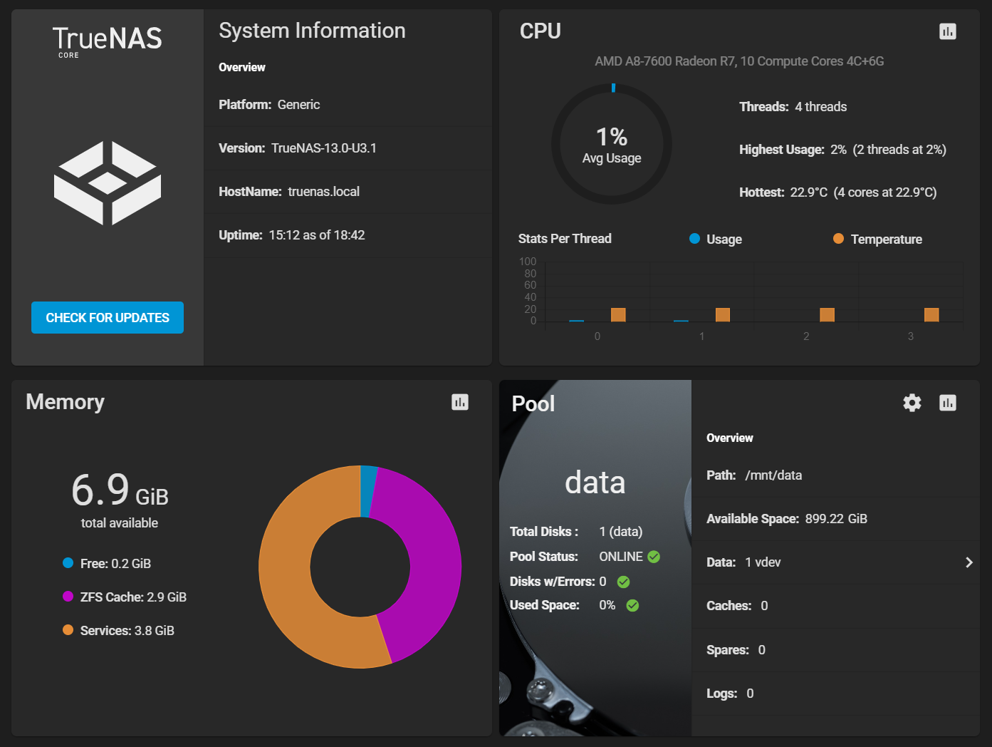

I assume that you already have TrueNAS setup. Here is my machine for demostration.

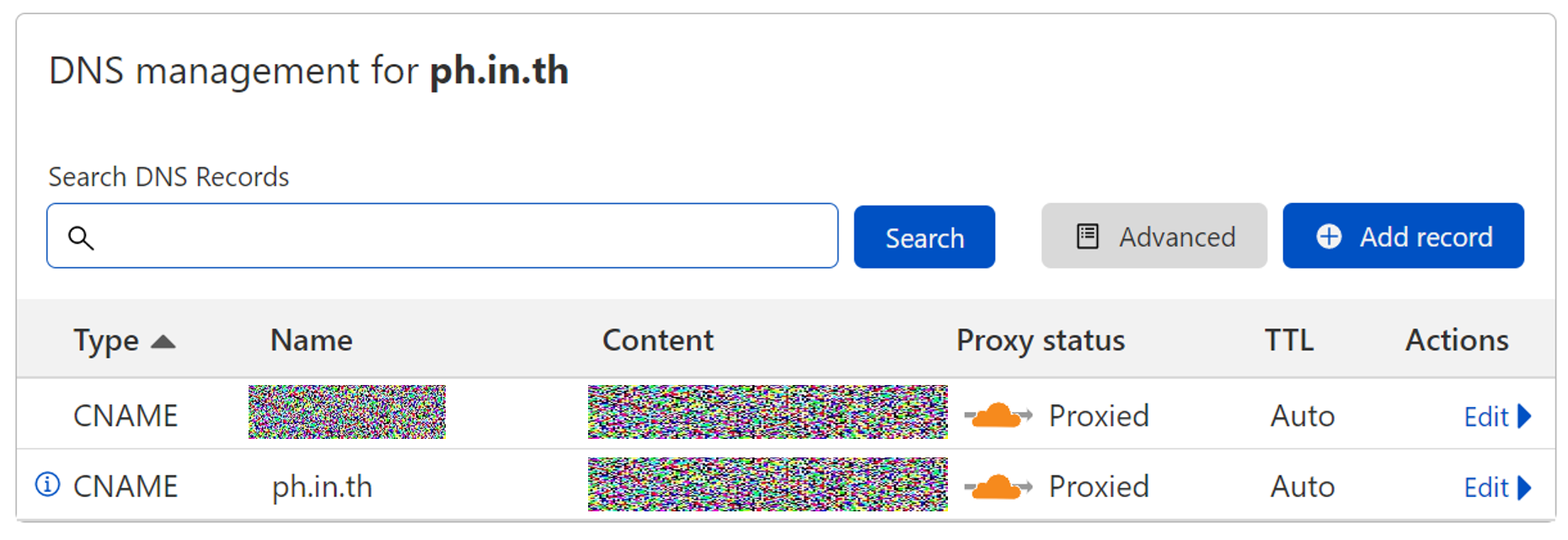

Also, I assume that your Cloudflare is already pointing to the domain. Here, I use ph.in.th for demonstration.

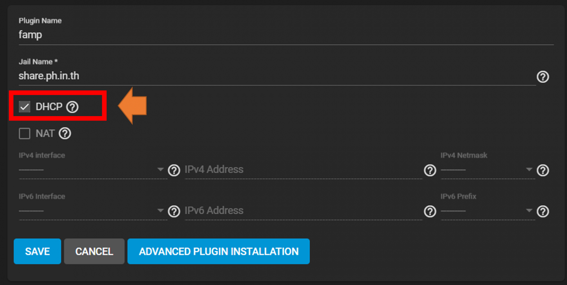

Step 1: Setup a jail
You can use any jail as you want. But for this guide, I will use FAMP. For the less messy, I prefer to use DHCP (make jail to have different IP from the host)

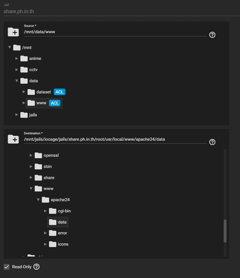

Step 1.1: Mount the dataset to the jail
I will create this jail for sharing my file to the public. You may skip this step if you use other plugins / jails. But if you use FAMP to share files like me. Mount the dataset to /usr/local/www/apache24/data to share across the internet. I prefer to check read-only. It will prevent the jail that exposing to the internet write something back to my dataset.
Also, if you cannot mount because the folder doesn't empty. You have to delete index.html first by opening the jail's shell and using the command "rm /usr/local/www/apache24/data/index.html"

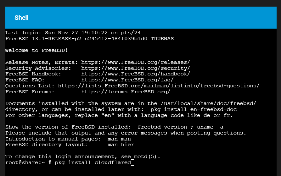

Step 2: Install cloudflared to the jail

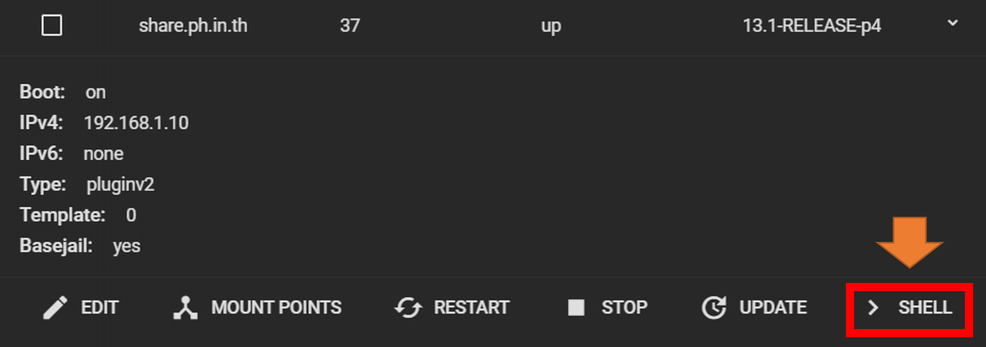

In the jail page, you will found the shell button

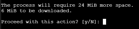

Then, type: pkg install cloudflared
It will confirm your request, press "y"

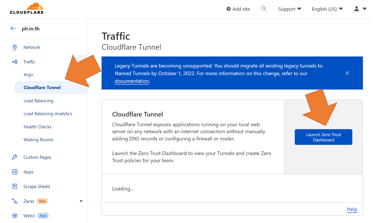

Step 3: Setup on the cloudflare website
Under the traffic tab, it will be a Cloudflare tunnel button, click on Lauch Zero Trust Dashboard

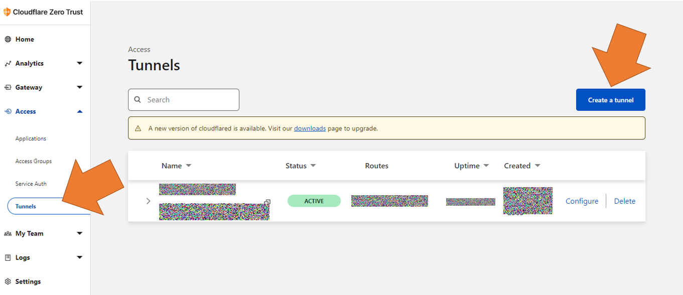

In the zero trush dashboard, go to Access > Tunnels, then click "Create a tunnel"

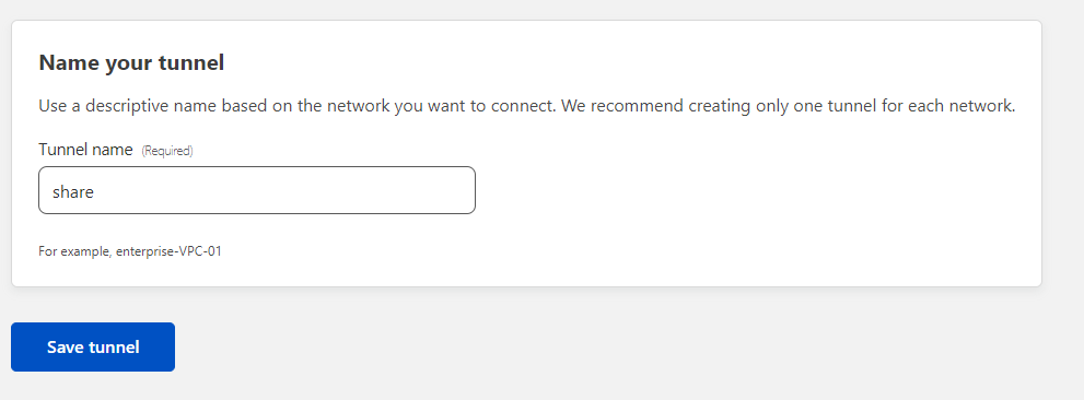

Then, it will ask to name a tunnel, i will set it to "share" but you can use whatever you prefer.
