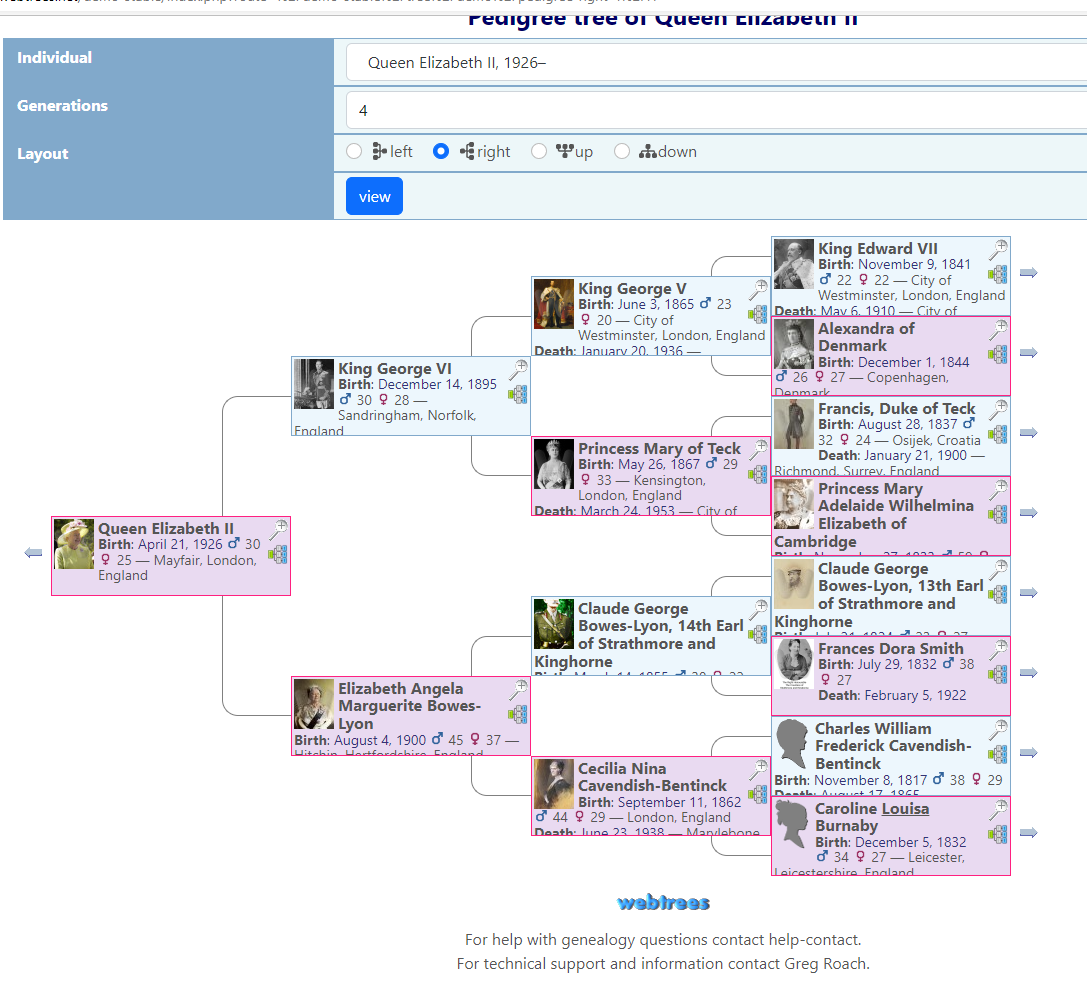

I am looking for some guidance. I would like to host a family genealogy site on my TRUENAS server. I see the posts about not trying to use the mail server part of the FAMP stack, because of security challenges. I am just trying to host this program and navigate through the GEDCOM genealogy file. This is the program I would like to use. https://webtrees.net/install/ Will I end up regretting trying to keep the wolves from the door?
The FAMP install guide is 7 years old, is it current enough?
https://www.digitalocean.com/commun...ache-mysql-and-php-famp-stack-on-freebsd-10-1
What is the equivalent of "hello world" for the Stack. Below is the kind of files that can be generated. (Obviously this is the demo tree, not my family)
Installation is described here to describe the dependencies.
Installation steps​
  • Check the version of PHP on your server.
  • For PHP 8.0 and later, download webtrees-2.1.7.zip.
  • For PHP 7.1 to 7.4, download webtrees-2.0.25.zip.
  • Unpack this file on your computer. You should have a folder called webtrees.
  • Upload the contents of the webtrees folder to a folder on your web server.
  • Visit your site in your web-browser, and follow the instructions.
  • After the installation is complete, you will be prompted to create or import your first family tree.
