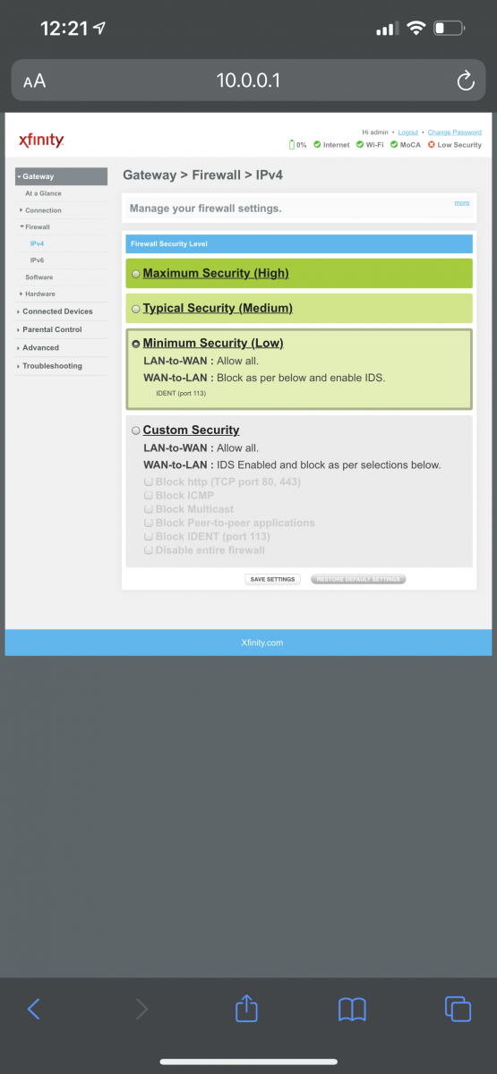

My current firewall setting is as shown in the screenshot, but I will try disabling it entirely to see if that changes anything.

Forgot to include the screenshot *facepalm*
