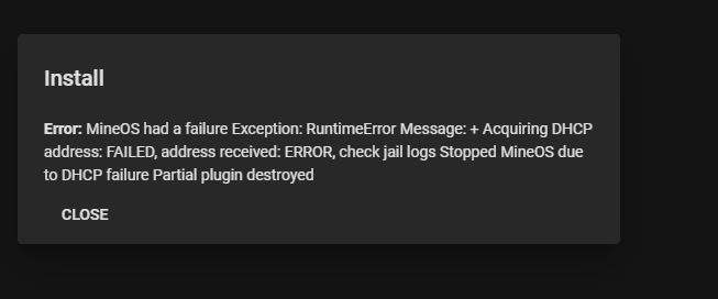

Mewandwing
Nov 20, 2021
Hi guy just starting to play around with it all, trying get MineOS Plugin install and im getting this error
How can I get this fixed?
