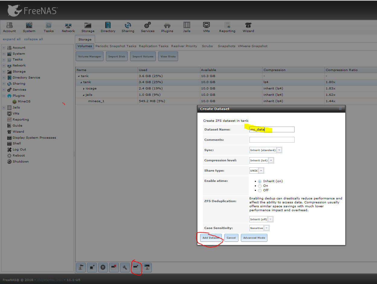

- Go to Volumes > Storage and create a new dataset, e.g. mc_data (avoid spaces)
- Go to the FreeNAS command line and copy the files from your jail to the new dataset. Assuming the jail dataset is /mnt/tank/jail and the new dataset you created is /mnt/tank/mc_data, you would execute:
