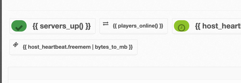

Thank you for the installation instructions, this helped a lot on a FreeBSD 12.2 jail.
Unfortunately the web UI seems to be broken, see image.
Any suggestions on how to resolve this?

Check that mount_fdescfs, mount_procfs and mount_linprocfs are set and SHIFT-refresh the page.
These are gone from the UI, now. You will probably need to use iocage set ...

Thanks, Patrick. The first post lists these commands, but indeed also refers to the infamous checkboxes that no longer exist. :frown:
mount_fdescfs is on by default, so it's not listed.
Yes, they are set. Outside the jail:
$ iocage get -a mcserver | grep ^mount
mount_devfs:1
mount_fdescfs:1
mount_linprocfs:1
mount_procfs:1
mountpoint:readonly
Inside the jail:
$ mount -l
Media/iocage/jails/mcserver/root on / (zfs, local, nfsv4acls)
procfs on /proc (procfs, local)
linprocfs on /compat/linux/proc (linprocfs, local)
devfs on /dev (devfs, local, multilabel)
fdescfs on /dev/fd (fdescfs)
Software versions are npm 6.14.8, node v15.14.0, openjdk version "16", freebsd-version 12.2-RELEASE-p6, mineos-node is on commit b2ce276c212170da1a24549d1e2b066ccf62f3a8, from May 26 (currently the latest one).
Shift reload, switching browser, using private browsing dit not help. I cannot click any link on the page.

Anything interesting in /var/log/mineos.log inside the jail?
The MineOS plugin is using node v16.2.0, and the "latest" pkg repo, where by default standard jails are using "quarterly".
Did try with "latest", or the plugin (it was just updated yesterday)?
Thank you! It seems to me that this helped. I changed to "latest" pkg repo and updated all packages. node is now in version v16.2.0.
I then removed the git repo from /usr/local/games/minecraft, checked it out again and built/downloaded the npm packages as instructed.
Now the server seems to run.
Only thing was that the latest BuildTools cannot be downloaded via the web UI, instead I needed to download them manually to /var/games/minecraft/profiles/BuildTools-latest.
