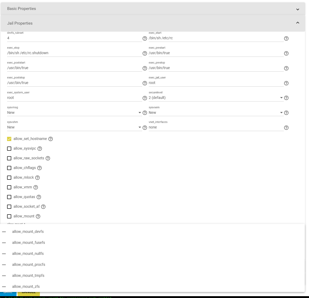

Setting linprocfs using iocage works on TrueNAS 12.0, it is not available through the UI, though.
Also, I wonder where mount_linprocfs actually mounts the filesystem, and whether it will be visible at /usr/compat/linux/proc?
Jul 10, 2016
521
Hmmm... you are correct; both flags mount_procfs and mount_linprocfs do not show in the UI of TrueNAS-12.0-U1
This is a regression from FreeNAS 11.3. Use the command line as per @Patrick M. Hausen 's post above until this gets sorted out.
iocage mounts procfs on /proc and linprocfs in /compat/linux/proc in your jail.
➜  ~ mount | grep procfs | grep mineos
procfs on /mnt/ssd/iocage/jails/mineos/root/proc (procfs, local)
linprocfs on /mnt/ssd/iocage/jails/mineos/root/compat/linux/proc (linprocfs, local)
Issue logged in JIRA: https://jira.ixsystems.com/browse/NAS-108867

I was able to fix my issues on my old servers in the new jail by simply
chown -R jimstein:mcserver /var/games/minecraft/*
This is counter intuitive and the reverse of what I want (mcserver:games) but this allows me personally edit files through a SMB share and mcserver can be used to login and manage the list of Minecraft servers. This setup do not allow me to have anyone else log in to MineOS or anyone else edit the files on the SMB share. This is not needed but I want it to be setup to allow that.
The problem with the Profiles was also solved by doing this.
But still:
* I can not start my old server even if they now are listed in the webgui.
* I can create a new server from import and run it but it will not start on reboot.
* The problems remains with the new servers that never was started that they are not listed in gui. I had one join the server list but it was lost again after restarting the webgui.

To fix that one needs to downgrade:
pkg delete -y openjdk11-jre
pkg install -y openjdk8-jre
If your jail is v12 you should also do some mounting from the host.
mount -t fdescfs null /mnt/red/iocage/jails/mineos-12-jail/dev/fd
mount -t procfs null /mnt/red/iocage/jails/mineos-12-jail/proc
The mounting needs to be done permanent by adding it to fstab or as a postinit script
These are easily available in the jail settings in the UI. No need to script it on the host.
Apr 16, 2016
18
Actually, the fdescfs flag does not exist in gui. It can be set by
iocage set mount_fdescfs=1 mineos-jail
You can just aswell do when your at it
iocage set mount_procfs=1 mineos-jail
I did also need to create the folders /dev/fd and /proc in the jail before I could mount, ofc.
