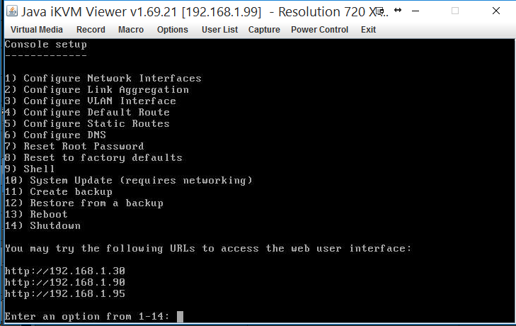

I just switched my port forwarding to point back to my desktop TS server, and had a friend log into my TS server successfully using my DDNS hostname. This proves that the issue is not in my router or DDNS, but somewhere in my FreeNAS box.
By my own humble estimation, when I forward ports to xxx.30 i am forwarding to the main Freenas OS, rather than my TS jail, which is why i am unable to connect.
I took a screenshot through IPMI which shows that xxx.30 is now a url to be used as a web interface.
Thanks in advance to the saint who helps me correct this issue.
