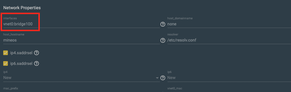

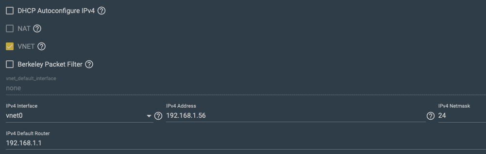

In your jail settings
  • change the "auto" in vnet_default_interface to "none"
  • configure IP address, netmask and default gateway
  • down in the network settings set interfaces to "vnet0:<your bridge you just created>"
My setting is "bridge100" which is the bridge connected to VLAN 100 in my network ... just a name that I picked.
That should do it.
