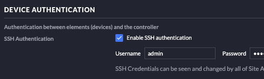

Still not working. I'm sure it's something dumb I am doing.
None of these work. They ask for a password but the password never passes. "admin" is the name of the SSH account on the controller. The IP and domain both ping.
ssh admin@unifi.local
ssh root@192.168.1.3
ssh root@unifi.local

You need to add the "admin" user manually in the jail ... did you do that?
Netdewt
Jan 19, 2021
98
You guessed it, nope.
Maybe it would be easier to make the ssh username "root"?

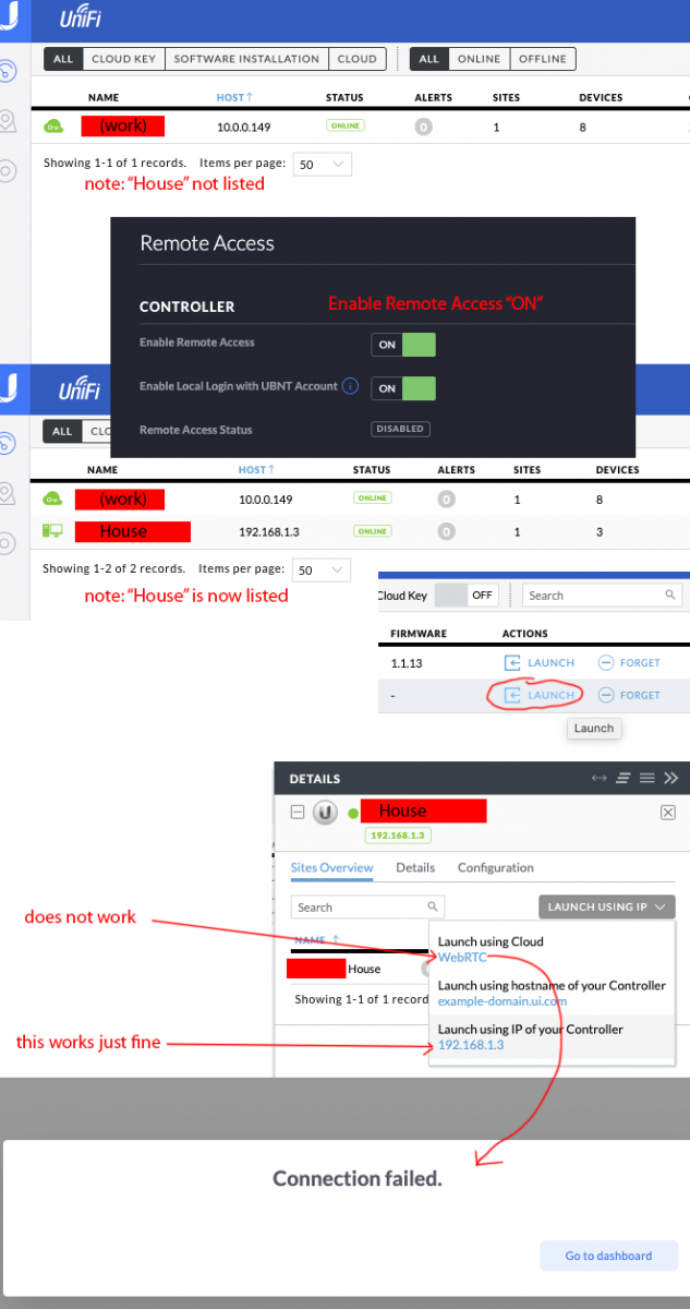

I'm about to give this up. It's not super important, it just bugs me that WebRTC doesn't work. My other installs of Unifi have all worked with no hassle.

From what I understand, it's what enables remote management without a VPN or port forwards. In the past I have run a controller on 2 different macs and I have used the older style of Cloud Key. Not a lot of experience, but just saying it's never been an issue. A few other people seem to have had the issue in my Googling.

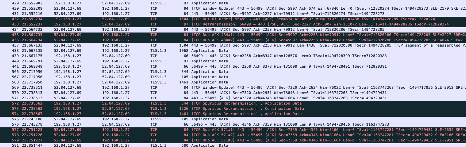

Here is a sequence I did while doing a tcpdump. I started with Remote Access off, turned it on, then attempted to access via WebRTC at network.unifi.ui.com.

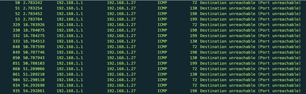

I'm not really sure how to show you this information. There's a whole bunch of "port unreachable" ICMP stuff between my mac and my router. There's also a bunch of retransmission and out of order stuff on tcp port 443 between a CloudFront IP and my Mac.
