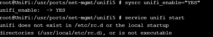

Hi
Hope someone can help me out, I've followed this guide https://forums.freenas.org/index.php?threads/installing-ubiquiti-unifi-controller-in-a-jail.55317/ twice and get stuck at the last stage. I am unable to start the unifi service (see below)
Doe's anyone know why I am unable to start UnIfi controller?
gt2416
Feb 4, 2018
262
go to that folder and see why its complaining
cd /usr/local/etc/rc.d
ls
post the output

Strange It does not seem to be able to find the file even though I assume it should be there seen as Iv'e followed the guide.

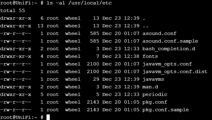

what does this do:
ls -al /usr/local/etc
thejamesk
Sep 2, 2018
71
wait.
you have no /usr/local/etc/rc.d?
Something bad has happened.
what does this do:
Thanks for helping! Here is what -al /usr/local/etc displays when in the Shell for UniFi Jail
