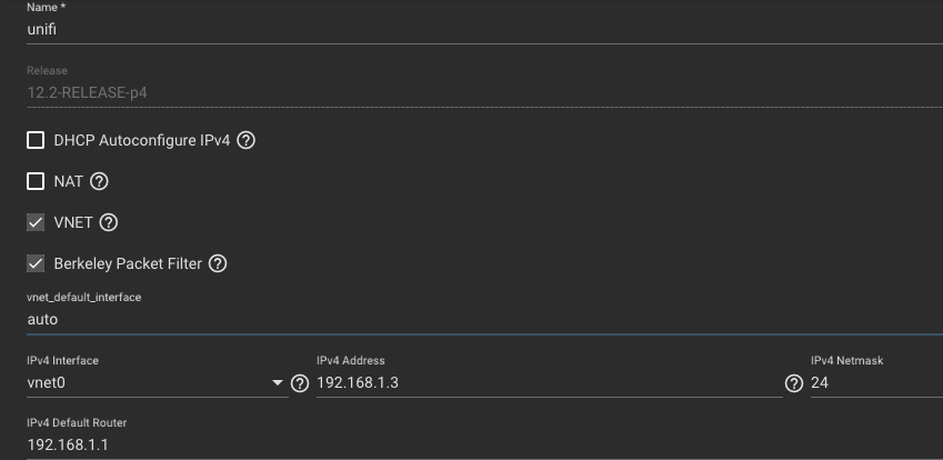

initial jail setup that I do and works for me:
Create a NEW jail using advanced
Name it whatever.. I selected 12.2 jail
I checked VNET and BPF
vnet_default_interface = auto
IPv4 Interface = vnet0
IPv4 Adress = whatever matches your network
IPv4 Netmask = whatever matches your network .. probably 24 for most
IPv4 Default Router = Gateway address

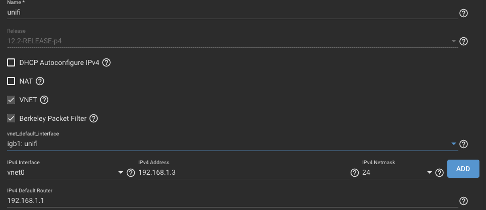

Whoops, I added these, it nuked my home network, and now I can't connect to TrueNAS at all. I did not have BPF checked and vnet default interface was set to none. Not quite sure at the moment how to regain control. No IPs online.

If you use the "auto" setting, TrueNAS will create a bridge with your main interface as a member. That sometimes messes up things if there are already other bridge interfaces present. A reboot should fix that and bring networking back.

After you added the screenshots - you cannot combine "auto" and pick a particular pre-created bridge down in the network settings at the same time. You need to decide if you want to use "auto" and have TrueNAS manage the bridging or not. If the former, delete all manual bridge interfaces, set to "auto", your jail will be conbected via bridge0 (auto-created) to the physical interface that has the default gateway.
If the latter, set it to "none" again and configure manually. You said your jail IP was online. I.e. it pings? Did you enable and start the Unifi servicr in the jail? :wink:

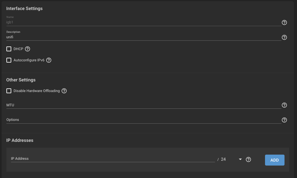

So, instead I turned off my second network interface and deleted the bridge. Plugged HDDs back in and booted. All is back to the way it was.
So now, what settings do I need in Network interfaces to use the auto bridge?

Delete all bridge interfaces. Set the jail to "auto". Reboot. You should end up with an automatically created bridge0 with yor LAN interface and some vnet* interface as members once the jail is booted. You can check that with ifconfig on the command line.
