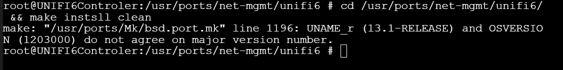

I tried to follow step by step the installation but problem here :
