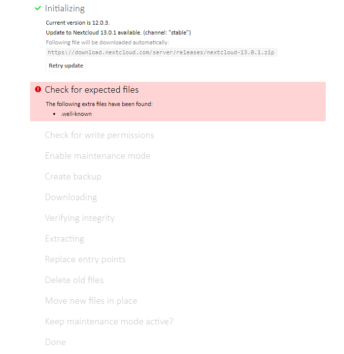

If your Nextcloud 12 installation is working fine, you should be able to just use its built-in updater to update to Nextcloud 13.
http://doc.freenas.org/11/jails.html#using-iocage
https://github.com/iocage/iocage

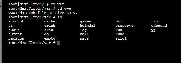

Thanks by the answer! I follow all this guide and it works pretty well! Whe I want to use the built-in updater I have this issue:
I read a lot of post with the same problem but I couldn't resolve it yet.
15,504
.well-known isn't showing up in ls because it's a hidden file (the . at the beginning of the directory name makes it hidden). It should be in /usr/local/www/apache24/data/nextcloud.
Edit: But we should probably update the virtualhost configuration file to put .well-known outside the nextcloud base directory. I'll work on that in my scripted install.
