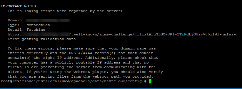

- certbot setup, I could not get the certificates to create with "certbot certonly --webroot -w /usr/local/www/apache24/data/nextcloud -d YOURSITE.COM" and instead used "certbot certonly --standalone --email your@email.com -d server.domain.com" which I got from https://www.reddit.com/r/sysadmin/comments/41wlj2/installing_a_signed_ssl_certificate_in_an/
Then, after finally getting it working, and an F on ssl labs, and using your guide on rebuilding ssl and apache, ssl labs reports A+.

Hello.
I almost there... I've all up an running but I'm getting an issue with SSL.
certbot certonly --webroot -w /usr/local/www/apache24/data/nextcloud -d mydomain.com
File "/usr/local/bin/certbot", line 6, in <module>
from pkg_resources import load_entry_point
File "/usr/local/lib/python2.7/site-packages/pkg_resources/__init__.py", line 3038, in <module>
@_call_aside
File "/usr/local/lib/python2.7/site-packages/pkg_resources/__init__.py", line 3022, in _call_aside
f(*args, **kwargs)
File "/usr/local/lib/python2.7/site-packages/pkg_resources/__init__.py", line 3051, in _initialize_master_working_set
working_set = WorkingSet._build_master()
File "/usr/local/lib/python2.7/site-packages/pkg_resources/__init__.py", line 659, in _build_master
return cls._build_from_requirements(__requires__)
File "/usr/local/lib/python2.7/site-packages/pkg_resources/__init__.py", line 672, in _build_from_requirements
dists = ws.resolve(reqs, Environment())
File "/usr/local/lib/python2.7/site-packages/pkg_resources/__init__.py", line 862, in resolve
raise VersionConflict(dist, req).with_context(dependent_req)
pkg_resources.ContextualVersionConflict: (cryptography 1.7.2 (/usr/local/lib/python2.7/site-packages), Requirement.parse('cryptography>=1.9'), set(['PyOpenSSL']))
Somebody saw that error ??
Regrads
Cristian

ml99
Oct 23, 2017
5
First off, thanks for this thread and to those who have contributed!
I'm looking for some help with the apache config, or at least that's where I believe my issue lies. Between the initial post and dureal99d's rewrite I've been able to get everything up and working, except for accessing nextcloud from my domain. I can access via internal and external ips, but whenever I use my domain it will not load.
Verified it's resolving to the external ip. Using wireshark it looks like it's getting redirected from http to https, which is not setup yet. I do plan on using https so I tried to set it up using certbot but it error'ed out saying that it could not connect to the site, I'm guessing for the same reason.
Noticed that it looks like there is a redirect setup on lines 5-6 below. I don't have a lot of experience with apache, but I went ahead and tried to simply remove the retwrite portions, set "Rewrite engine" to off, or change the "rewrite rule" to http but no luck.
<VirtualHost *:80>
DocumentRoot "/usr/local/www/apache24/data/nextcloud"
ServerName cloud.mydomain.com
RewriteEngine on
RewriteCond %{SERVER_NAME} =cloud.mydomain.com
RewriteRule ^ https://%{SERVER_NAME}%{REQUEST_URI} [END,QSA,R=permanent]
#ErrorLog ${APACHE_LOG_DIR}/error.log
#CustomLog ${APACHE_LOG_DIR}/access.log combined
<Directory /usr/local/www/apache24/data/nextcloud/>
Options +FollowSymlinks
AllowOverride All
<IfModule mod_dav.c>
Dav off
</IfModule>
SetEnv HOME /usr/local/www/apache24/data/nextcloud
SetEnv HTTP_HOME /usr/local/www/apache24/data/nextcloud
Satisfy Any
</Directory>
</VirtualHost>
An advice on how to bypass the redirect, at least long enough to set up https? Or as to what else may be going on?
Thanks!

When I try and setup certbot I get the following:
ml99
Oct 23, 2017
5
Thanks. Still not sure why it wouldn't connect over http, but I was able to get around it by setting up a self signed cert and then running the certbot config.
