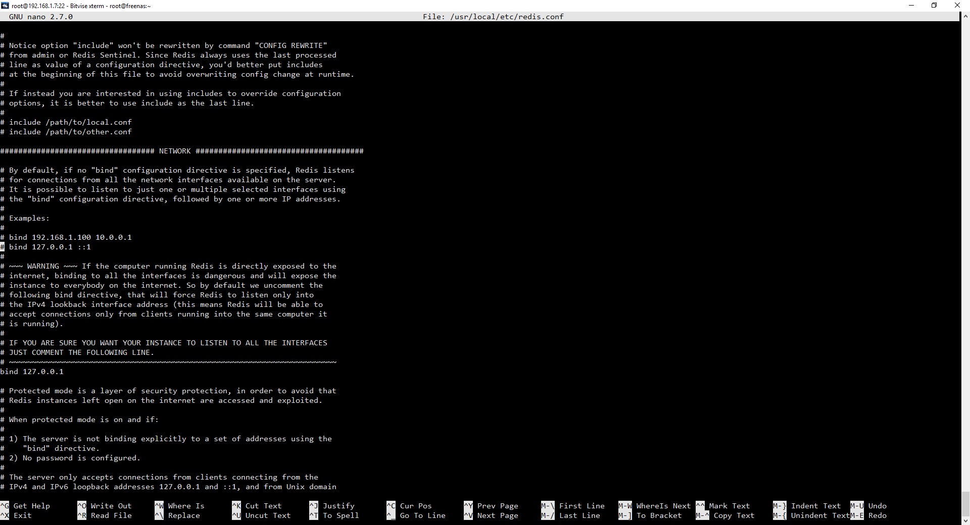

I looked at my redis.conf and it does not have the '=' so I will edit the post to reflect that.
Type service redis status and if you get a PID number it means it's running. Try going through the redis setup again.

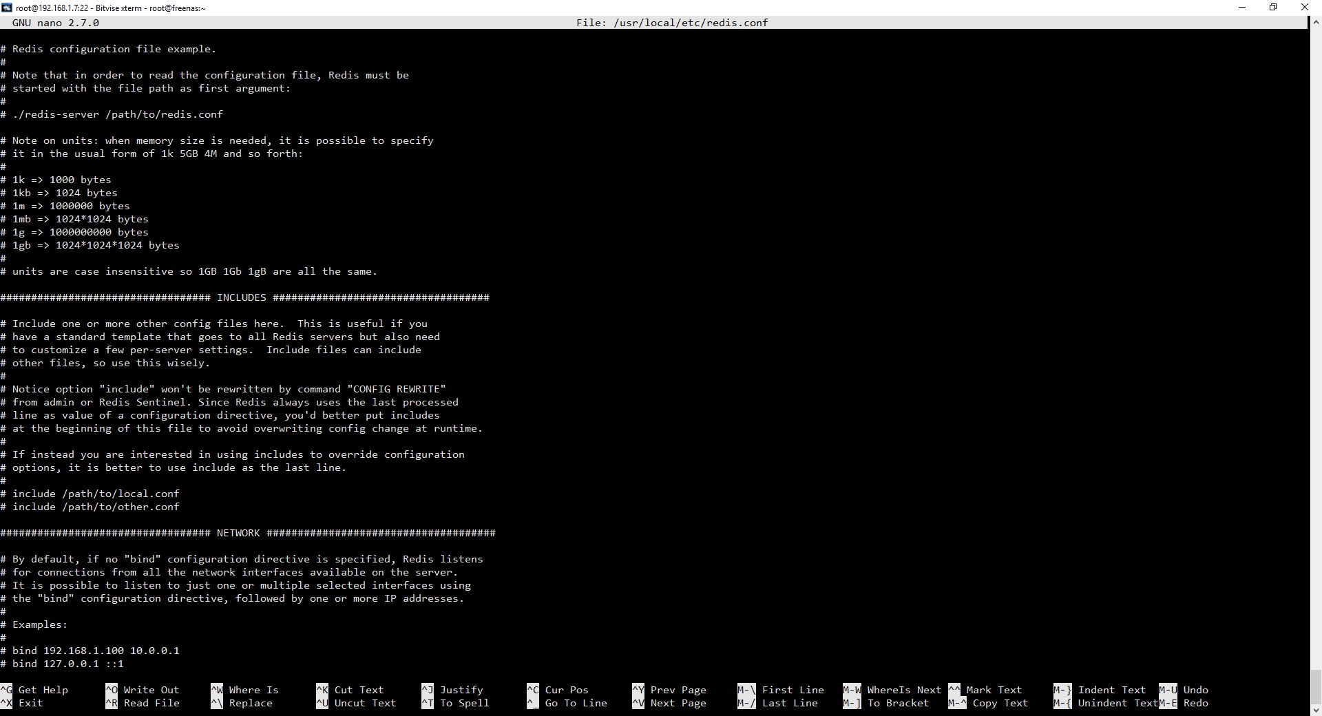

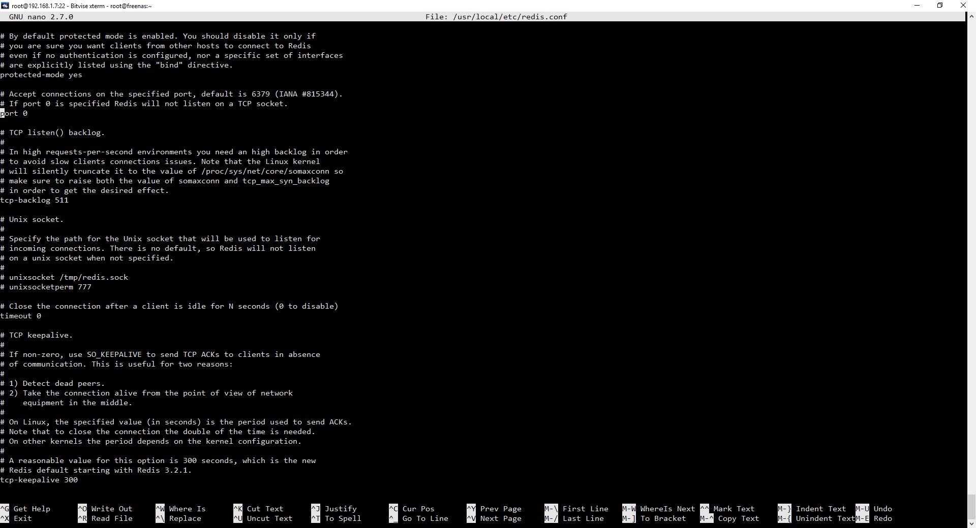

Here's a pic of my redis.conf file with the area in question
So check thAt your Apache configuration is set up to point to where your nextcloud is installed at.
Make sure nextcloud is downloaded and extracted to the right place
Make sure you start the redis server service redis start and that it's in your /etc/rc.conf. File
And in redis.conf try changing unix permissions to 755
(my guide mistakingly had 750, and when troubleshooting I changed it to 777 and forgot to change it to the recommended 755 so thank you for allowing me to catch that and change it ;) )
Needs to be 777 not 755
Hope this helps :)

ZodiacUHD
Aug 28, 2015
226
If you're see the It Works page, it means Apache hasn't been configured to point to the Nextcloud installation. Make sure you don't skip a step. Each one is important.
Hope this helps :)

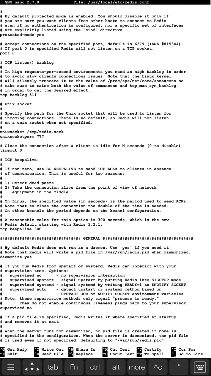

Here i am again, still stuck on the redis step, i'll attach a few screens of my redis.conf
By the way i tried to make everything from scratch, making sure to follow every single line.
EDIT: I felt dumb many times in my life, but this has to be in the top list. I forgot to remove "#". I'm now able to run REDIS and get to the nextcloud page.
EDIT 2: I'm getting SQLSTATE[HY000] [2002] No such file or directory when tryng to finish up the nextcloud setup

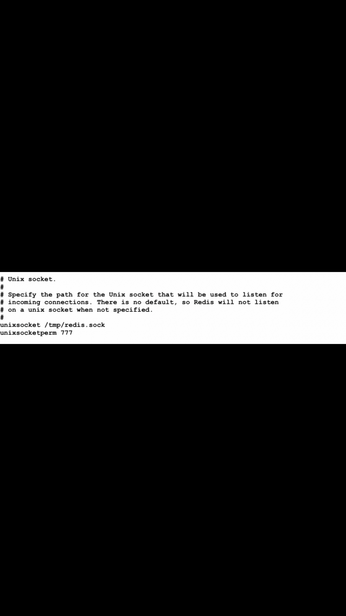

Uncomment the unix socket settings as seen in my attachement:
As for the SQLState error, I'm unfamiliar with that error, but I would double check the database.

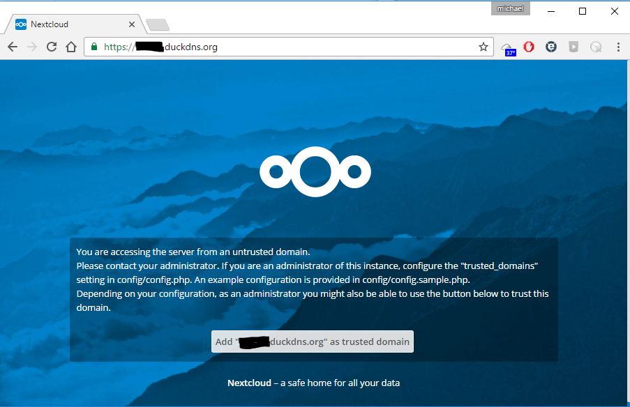

I think it's finally time for me to ask for help.
I've gone through everything and believe I have it all set up properly. When I go to my server address the nextcloud screen comes up with the following message:
"You are accessing the server from an untrusted domain.
Please contact your administrator. If you are an administrator of this instance, configure the "trusted_domains" setting in config/config.php. An example configuration is provided in config/config.sample.php.
Depending on your configuration, as an administrator you might also be able to use the button below to trust this domain. "
The there is a link to (Add "xxx.duckdns.org' as a trusted domain")
Any idea where I may have gone wrong? Thanks in advance.

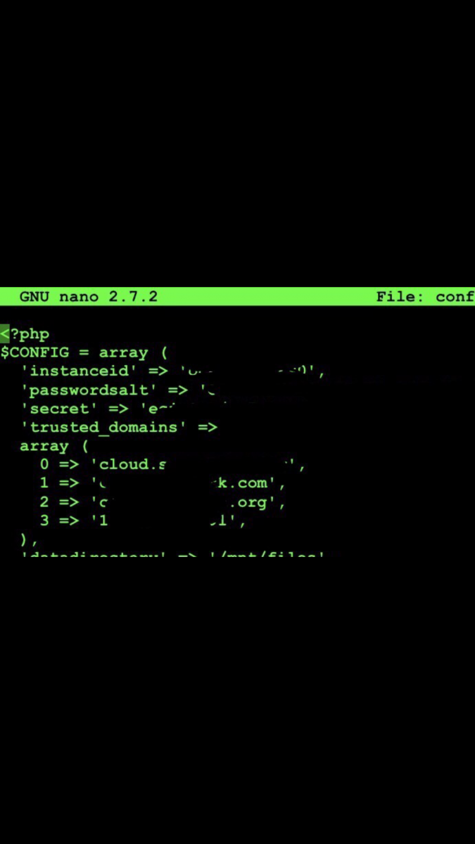

You need to edit the config file to include your domain.
So navigate to your Nextcloud folder
Then enter the config folder
Edit config.php
Find the "trusted_domains" array and replace what's there with your domain.
Where I have a few domains, you may only need one. Replace 0=> with your domain and save the file.
