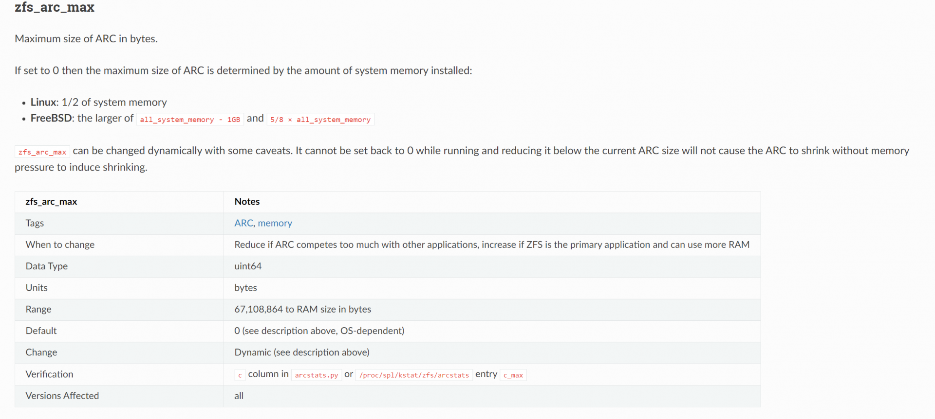

SCALE will automatically use about half of your RAM for ARC, or about 8GB. So whatever apps you use will be limited to about 6GB of ram. I am seeding over 2000 torrents right now and my qBittorrent is using less than 400 MB of RAM, and JellyFin isn't going to be particular RAM hungry either.

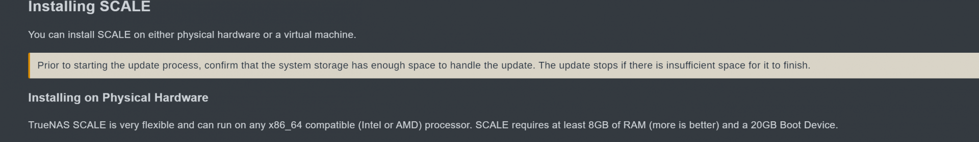

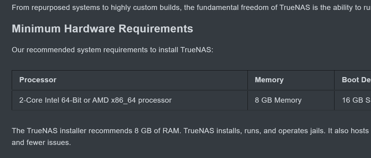

What information do you have to support this claim? The minimum is 8GB. He has 16. As always, with ZFS, more is better.
If anything, SCALE will likely be a bit more forgiving for a small system due to the very conservative approach to maxmium ARC (due to differances in the kernel between Linux and BSD).
Please stop posting generalizations with absolutely no teeth to them. The quantity of RAM in his server is fine.
On that contrary, that means (potentially) wasted RAM.

I literally just linked the manual for SCALE. Please consider clicking on the link and reading the manual. IX Literally sells Minis with 16GB of ram. I have one right now running SCALE. https://www.amazon.com/iXsystems-TrueNAS-Mini-X-Diskless/dp/B08FCWC3VC?ref_=ast_sto_dp&th=1
More RAM is always better. But 16GB is NOT the minimum. 8 is and has been since SCALE was released, and really has been the minimum for FreeNAS for a decade.
Or, considered another way, it means more RAM is statically allocated to the Linux kernel and any subsequent applications he may want to run, instead of being tied up in ZFS. In larger systems, I agree with you, and I personally have manually modified the maximum ARC because it is otherwise wasteful. In small systems like this,
If applications need that memory, the situation is at best the same. If they don't, it's unused memory and, as such, wasted.

I hear you, but for a first time user of the software not having to worry about server stability and RAM exhaustion, it's really not a bad default. For OP, he''ll probably have 2-4GB of RAM free and can experiment with a couple other apps in addition to those he linked and shouldn't have to worry.

TrueNAS CORE is still 8GB minimum
I am NOT saying that the performance of a system with 8GB of memory will be very good. ARC misses on a RAID Z1 with 3 disks are going to hurt perfomance pretty bad. But from a purely usability and stability standpoint, 16GB is plenty.
Even the community guide, written by some long time contributers here, including Mr Greco, states that 8GB is the minimum while they recommend 16GB.
TrueNAS really really isn't that fat. In 2012 when FreeNAS 9.x was released, the minimum was 8GB. The RAM requirements haven't really grown all that much since then, but 8GB was alot more to ask for back then. People would try and run on a system with 2 or 4 GB of DDR2 and run into stability issues. Now, a system will still happily run as a backup target with 8GB of RAM, and it's easy to get even with an older DDR3 based system. Performance is what will scale with RAM at these smaller nodes, and the payoff between 8 and 16 or even 16 to 32 is pretty big in terms of performance per dollar. But don't tell people not to use it because they have 16GB...
