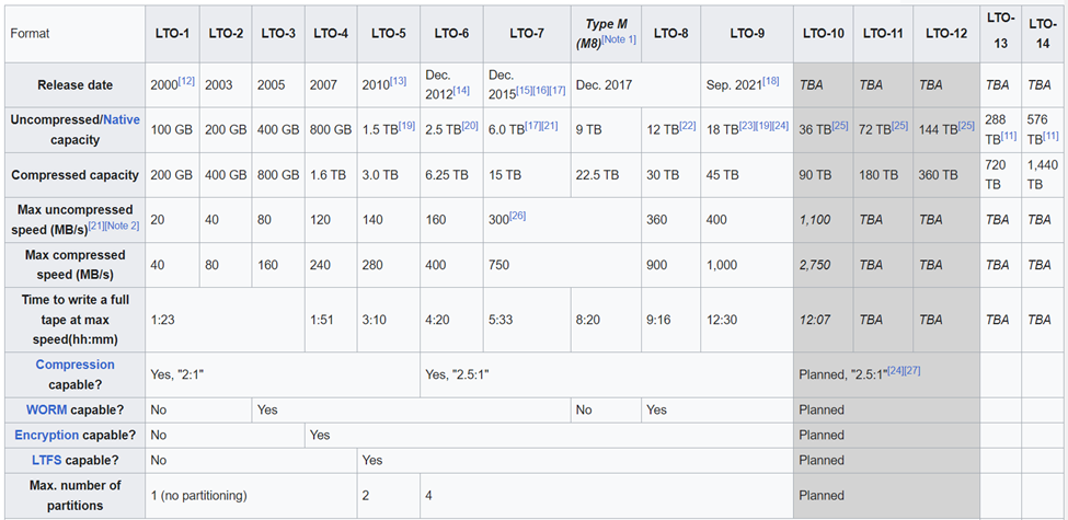

So it’s an old, dead format right? Like VHS or Betamax before it? Well, no. It’s actually a fairly regularly updated standard, with new releases every few years, and the most recent one being from 2021. Not to mention they have a pretty firm roadmap going into the future:

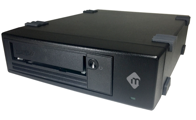

A tape drive is a device that can read or write, in this context, LTO tapes. They have come in several varieties over the years. They can be internal to a system in a 5.25” bay like a CD drive:
They can sit on your desk:
Think about a tape drive like you would think about a VHS tape, except for data instead of movies.

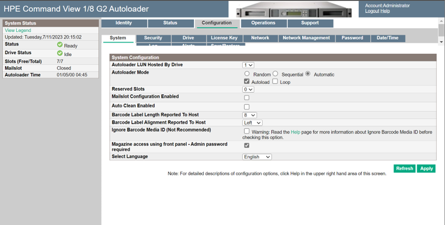

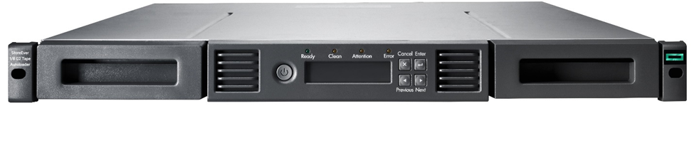

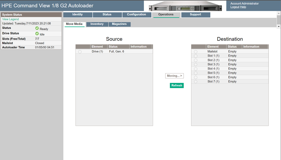

Ahh! Now that’s the question. For my purposes I am using an HP 1/8 G2 Tape Autoloader. It’s the same as the library pictured above. The 1 in the name means 1 drive lives in the library (some can have two or more), and the 8 means it holds 8 tapes. Autoloader means, much like the name implies, it can automatically load tapes into the drive for you!
HP helpful has as a little LCD screen on the front of the library that lets you setup basic networking configuration, and now we can access the library from the interwebs.
You can see I have 7 slots free out of 7 slots. Huh? I thought it was 8! That’s because there is one slot which is called a mail slot.

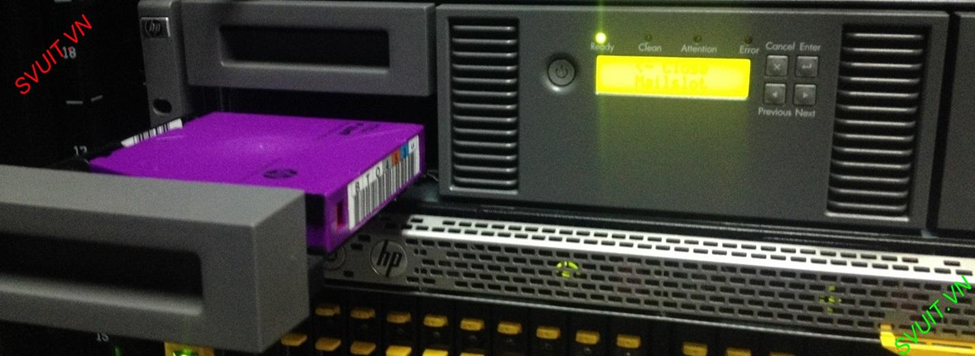

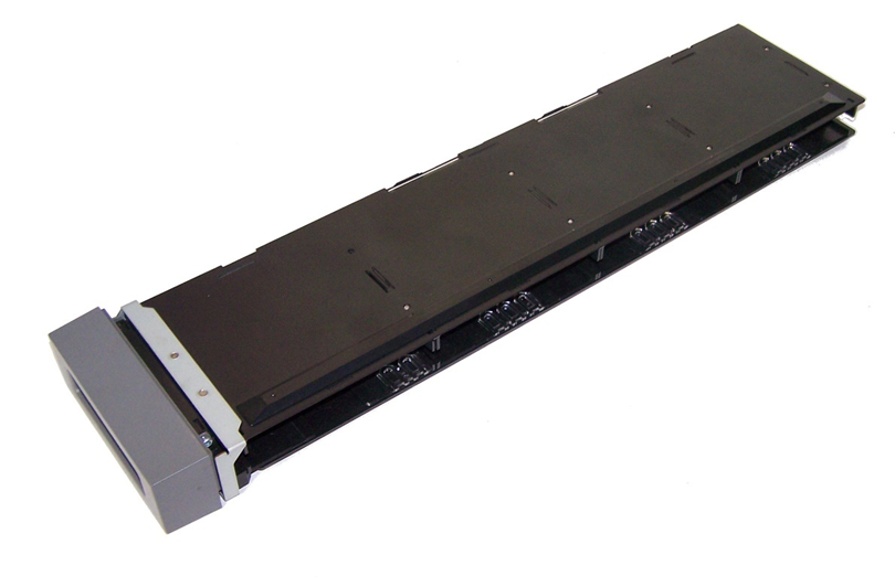

By default, you can take the entire magazine out of the thing:
In order to remove a tape. When you are swapping out multiple tapes, this is fine. But if you only need 1 tape, it’s kind of a lot of work. With a mailsot, things are simpler and you can just remove a single tape
The library will automatically, with a little robot, move your tapes around for you at your request. Here, I just commanded it to move the tape currently in the drive into the mailslot, as an example:

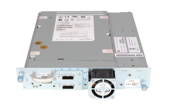

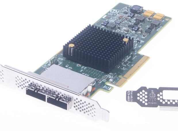

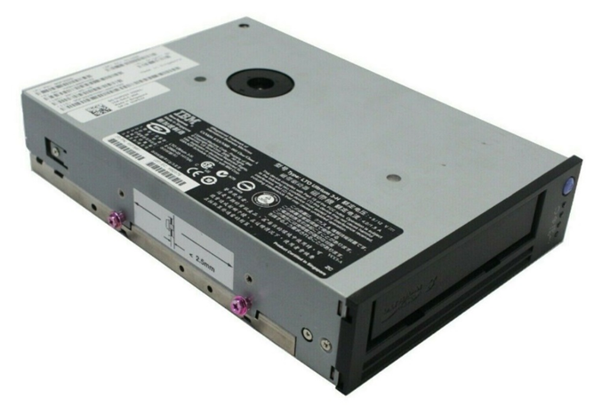

In this case, Little Lenny has a SCSI connection directly into my tape library using an 8087 SAS cable. This is an example picture of what the drive inside of my library looks like:
The 8087 cable plugs into a SAS HBA, like a LSI SAS9207-8e, just like if I were to connect a disk shelf.

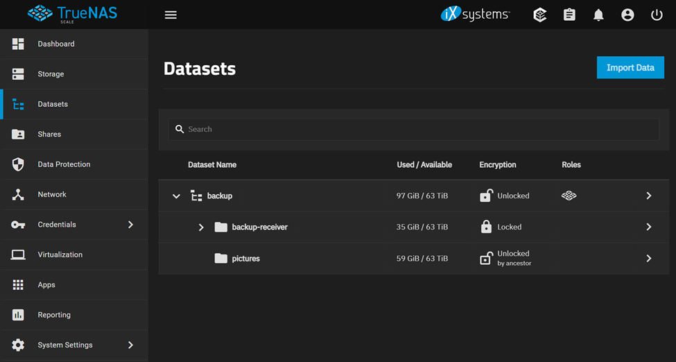

Now in Little Lenny, I have my dataset called pictures which has precious family moments I would rather not lose.

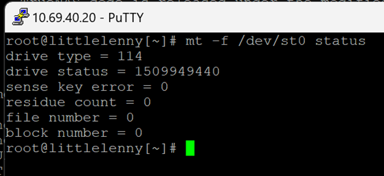

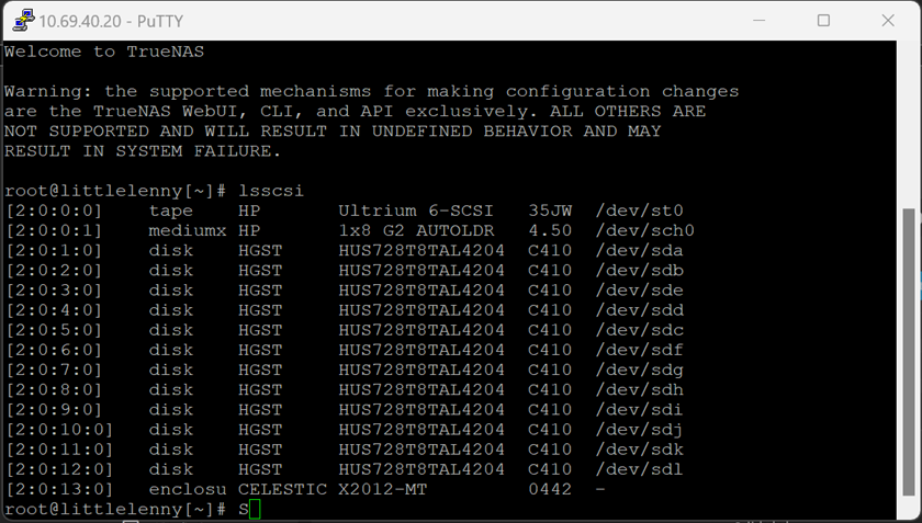

Lets go over to the shell. Type ‘lsscsi’
Nice! My tape library is detected, and it’s at /dev/st0
Now we can use the Linux command ‘mt’ to interact with it.
Let’s type:
mt -f /dev/st0 status
And for me it looks like it can see the tape and interact with it, we are ready to move on:

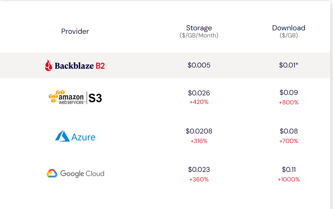

Why Not the Cloud?
I believe in owning my data. If I have an emergency and I need to recover my data, I do not want to be ransomed by the people in the cloud with whom I have entrusted my data. I have a moral objection to egress fees because if things are bad enough that I have to recover from 3rd tier backups, then adding fuel to the fire and having an additional cost makes me mad.
Backblaze is well respected and is generally cheaper than it's bigger brand competition.
Let's use the 2.5TiB as our number, which is the maximum I can store on a single tape. Let's scale out the timeline, and there is no guarantee that pricing won't increase over time.
Backblaze will cost about $12.50 for the month or about $150 for a year.
That's $300 at year 2.
That's $750 at year 5.
Now let's assume I have to retrieve my data at least once. Add another $25.
We're at $775.
Now lets assume I have 8 times that amount of data I would like to backup, which corresponds to the number of tapes I can store in my library.
With about 20 TiB of data, Backblaze will cost me about $6,000 over 5 years, and about $200 to retrieve my data only once.
