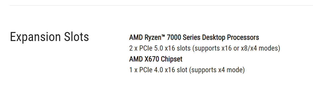

Lets consider for a moment the hardware configuration here. In particular, PCI-E bus topology MATTERS here.
In the example of system 1, the motherboard has this information:
ROG STRIX X670E-E GAMING WIFI | Motherboards | ROG United States
ASUS ROG Strix X670E-E Gaming WiFi features 18+2 power stages, DDR5 support, four M.2 slots with heatsinks, PCIe® 5.0, USB 3.2 Gen 2x2 front-panel connector, and onboard WiFi 6E. It also features AI Cooling II, AI Networking, Two-Way AI Noise Cancelation. ROG Strix X670E-E Gaming WiFi caters to...
rog.asus.com
But it's not quite that simple. Ryzen 7000 has a maximum of 24 PCI-E 5 lanes total, which would mean the motherboard has got to shuffle the deck quite a bit for all of this connectivity to work.
Asus does not share a good block diagram of this board. But based on the X670 block diagram we can infer that both x16 slots do go directly to the CPU. So it seems then, that I should theoretically have full PCI-E Gen3 X16 speed for the card in that system.

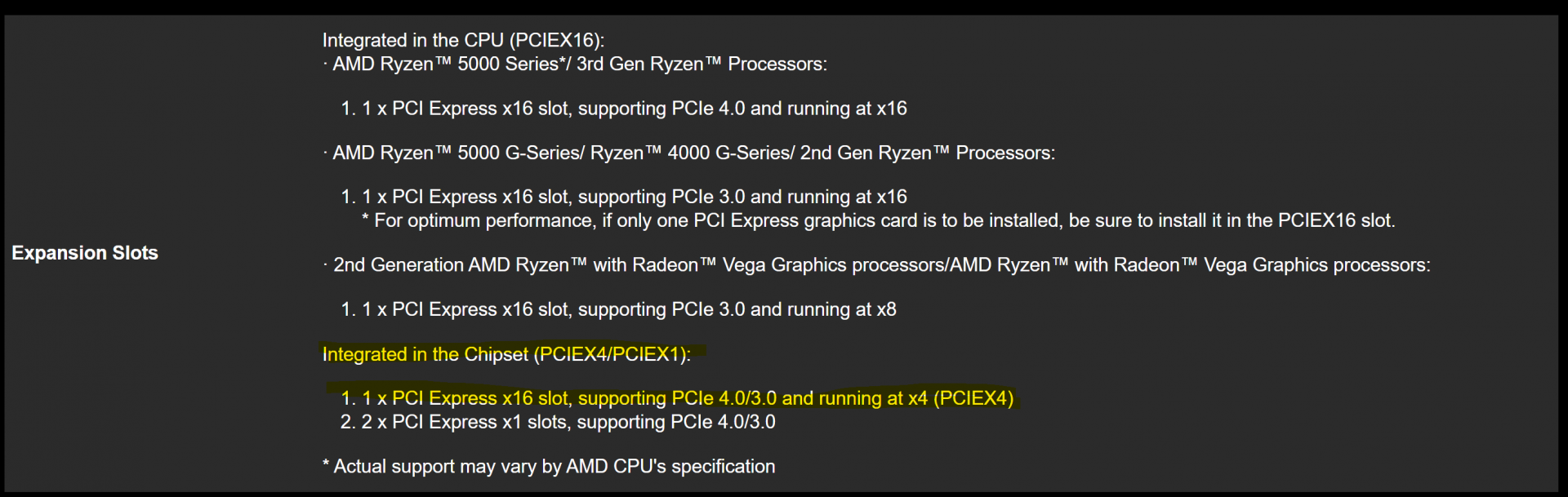

System 2 is even worse off. Despite windows report PCI-E Gen3, it is indeed going through the chipset. So while we have 32Gb/s of potential performance here, it's shared among other devices, we are going to be performing even less that that.
X570 AORUS ELITE (rev. 1.0) Specification | Motherboard - GIGABYTE Global

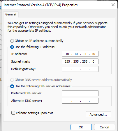

Layer 1:
We have here a simple PtP connection between two windows hosts. I re-ran my testing with a few different optics so as to ensure consistency. Despite some minor run-to-run variance, very little difference was observed between them:

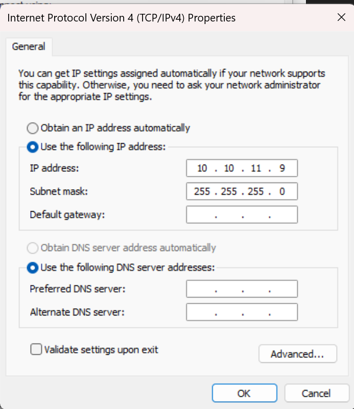

Layer 3:
Basic configuration:

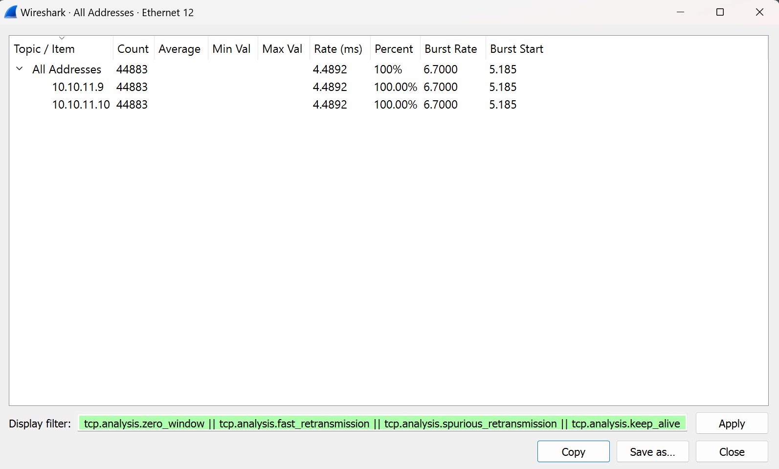

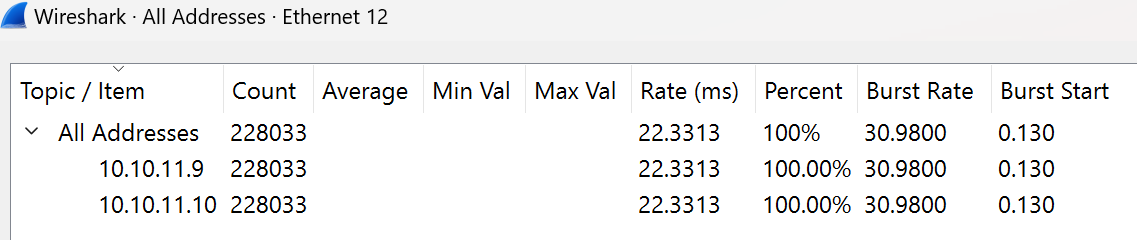

Taking a Peek at the Ether:
Using wireshark to capture data on the interface during an iPerf run, we have about 220,000 packets.
Filtering for some indicators of poor TCP performance:
tcp.analysis.out_of_order || tcp.analysis.duplicate_ack || tcp.analysis.ack_lost_segment || tcp.analysis.retransmission || tcp.analysis.lost_segment || tcp.analysis.zero_window || tcp.analysis.fast_retransmission || tcp.analysis.spurious_retransmission || tcp.analysis.keep_alive
13% of all traffic is being "wasted", so some additional tweaking may yield some additional performance, but it may also be that the inherent platform bottleneck on "System 2" is causing a cascading negative affect into the TCP stack.

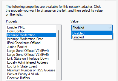

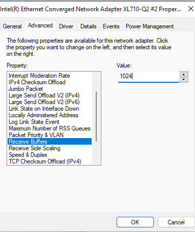

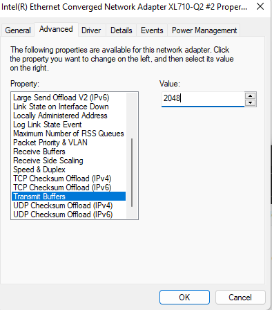

In my testing, in this environment, I found the best mix of performance between these two systems was with the following settings. The same settings were applied to both systems.
- Toying around with buffers, it seems that the best speeds I was able to achieve were with 2048 Send and 1024 Receive. Increasing the buffer sizes beyond these values decreased performance for me, but YMMV.

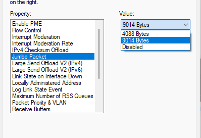

- Jumbo Frames to 9014 did seem to help, but in doing so I have statically increased the number of issues in the TCP stack.
- Interrupt Morderation Disabled made the biggest performance difference.

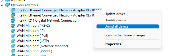

I found that in my testing, some settings did not properly revert back to defaults when I expected them to. The only way I was able to reset the NICs back to default properly was to uninstall/reinstall them in Device Manager:

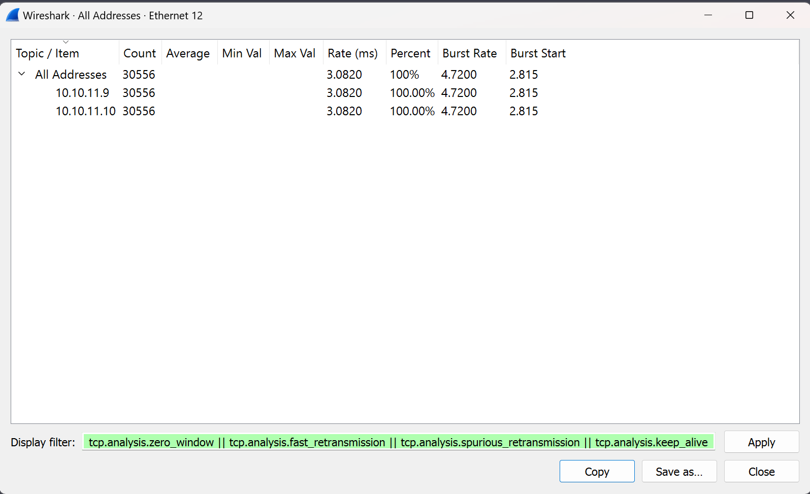

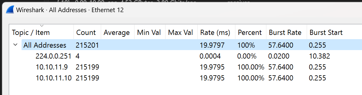

Re-running Wireshark after applying my settings:
There are 215,201 packets
And 44,883 packets are indicating potential poor performance still, which is actually higher than original at 20%!!
It seems I have hit the wall of this test platform, and would have to get a beefyer test environment to scale further.
