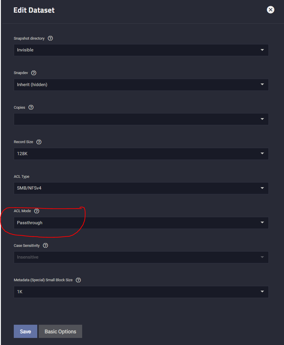

Some folks have reported issues with the automatic updates feature and it took me a while to replicate the error. Thankfully I do not need to release an update to fix this problem. The culprit appears to be the ACL's. I am not an ACL guru, but I am able to repeatedly create a new dataset that works properly, and create failing datasets as well. I've updated the User Guide (attached) and page 8 describes how to create a working dataset for this script. I suspect you could modify your current dataset ACL's as well. Since I'm not a guru on ACL's, if you find something incorrect or you have a better way to setup the dataset, I'd like to hear it.

NugentS
Apr 16, 2020
2,947
Its not an open acl issue - or rather wasn't for me. It was ACL Mode. Setting this to passthrough sorted the error out and the script now updates correctly.
Of course I have no real idea what passthrough vs restricted (which is how mine was set) means - must read the manual. I did try asking ChatGPT for a giggle, but got a load of irrelavent rubbish back.
Davvo
Jul 12, 2022
3,222
Iirc passthrough is a dataset property, open and restricted are ACL presets: they are different things.

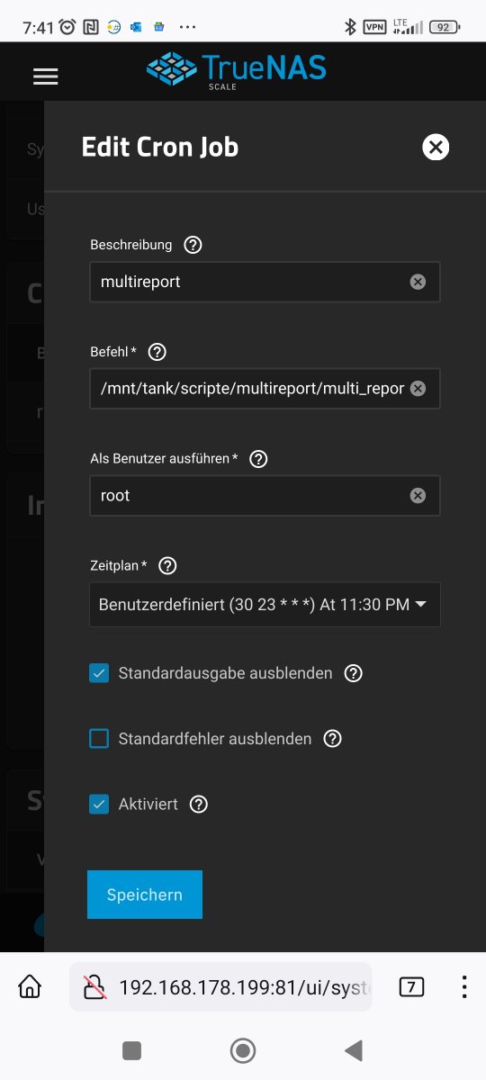

daschmidt
Feb 12, 2023
61
In the email the header is: SMART Testing Results for truenas - All is Good
And my cron settings are this:
NugentS
Apr 16, 2020
2,947
The "All is Good" is sent by multi-report itself. I am not aware of a setting to tun off All is Good reports

joeschmuck
Old Man
May 28, 2011
10,996
IIRC there is a way to only gets mails when you have errors, look in the PDF.
The All Good report is not optional for a normal run.
You can use the '-m' switch however I think it only sends an email for over temp situations, to "monitor" the temps for if you had a questionable heat issue.
@daschmidt If you would prefer to not receive "All Good" emails, I would recommend you filter your email to delete emails with "SMART Testing Results for truenas - All is Good" in the subject line.
