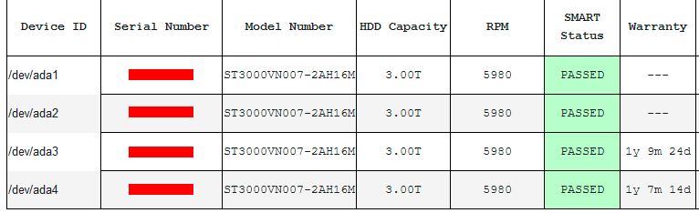

@joeschmuck I introduced new drives in my system and was wondering what did I need to do to add their warranty date in the script config file... my memory is a bit hazy regarding this procedure, and I haven't found much in the manual about it.

I had read that but wasn't sure about it being the right option. Anyway, thank you for your guidance.
I succesfully entered the two new drives dates... and encountered a minor issue: even after I press "enter" when the script asks me if I want to edit, delete or no change a drive, my two original drives' warranty dates were deleted.
I had to re-run the config option and re-enter all the drives' warranty dates, even the already registered ones.
Example after the first run (ada1 and ada2 are the original drives, do note the absence of warranty value):
Edit: just noticed it removed my SDD wrranty as well. Well, just gotta rewrite everything.
Sorry about that. When you choose Edit, it should have cycled through each drive and ask you if you wanted to enter the data, it should not have deleted any data. I will have to test out the current version to see if I let a bug get in.
Just tested it out and I should change this setup to ask something to address the drives that are already listed. When I developed this my mind set was that ALL the data would be entered at the same time, I am clearly wrong. I will make that change for the next version. I'm sure I made that assumption in other areas of the script as well, so I will need to step through every iteration to try to catch as many as I can.
Thank you for letting me know of the error and sorry for the inconvenience.
