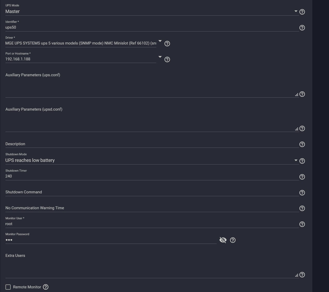

Perhaps it would be helpful if you posted a screenshot of your UPS settings. Is there anything unusual about your UPS configuration?

As I said before... I have no clue what is going on with your system. I'm curious, though -- how did you know to use port 161 to get data from your UPS?
Anyway, you can always just hard-code the script to work with your particular system. Instead of querying the system for the UPS device(s) it's attached to, we'll just plug in the UPS name.
Edit the script and browse down to roughly line 35. You should see this:
upslist=$(upsc -l "${freenashost}")
Replace the line with this:
upslist="ups50@ASrock:161"
Which should make the script work for you. Good luck.
